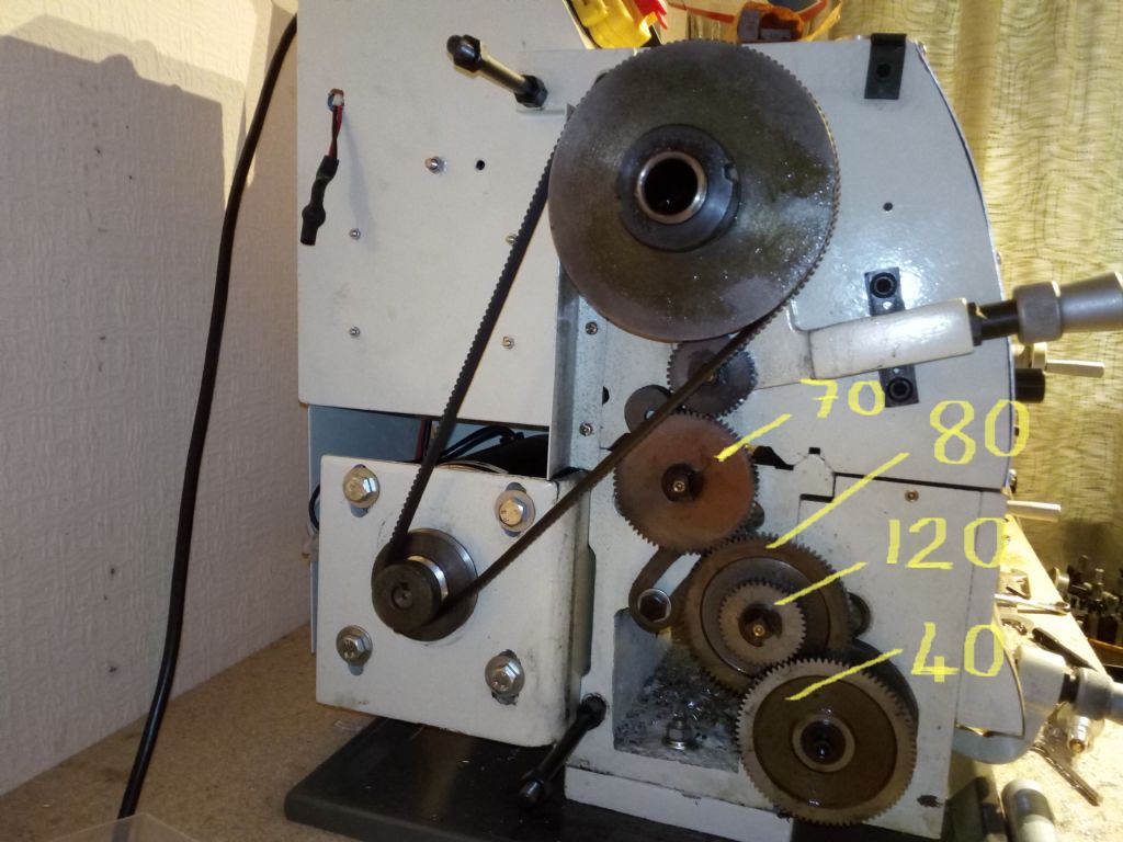

Aagghhhh I think something is wrong here, I have a tumbler driving a 70T, driving a 80T with a 120T on the same shaft (a) driving the 40T on the feed screw gear box (b), I have selected position 9 on the gear box and a scratch test shows about 24/25 tpi.
Is there something obvious I am missing or is it possible that the label stuck on the machine is the wrong one. Right now any ideas are very welcome.
Please see diagram below showing the number of teeth on that given position.,
Thanks, Ian

Managed to spot the mistake, I need the gearbox selector in position 9, not 1, doh.....

The 120 tooth gear that came supplied does fit, but only just, it's a fiddle to get it on. Having said that, I think I have got it wrong. I have cut a test thread (external) and am getting about 22 tpi. I have uploaded a photo showing the new gearing. Red gears unchanged, other gears shown and numbered, any ideas what have I got wrong?
Thanks,
Ian
