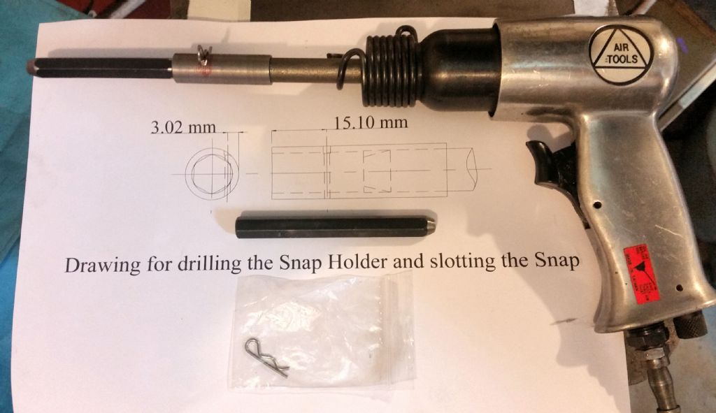

I've modified an air chisel hammer this last week to drive rivets. Seems to work with snap heads with a 1.7 times diameter stick through. The drawing seemed to be overkill, but at least I got the hole and slot in the right place for it to fit together nicely.

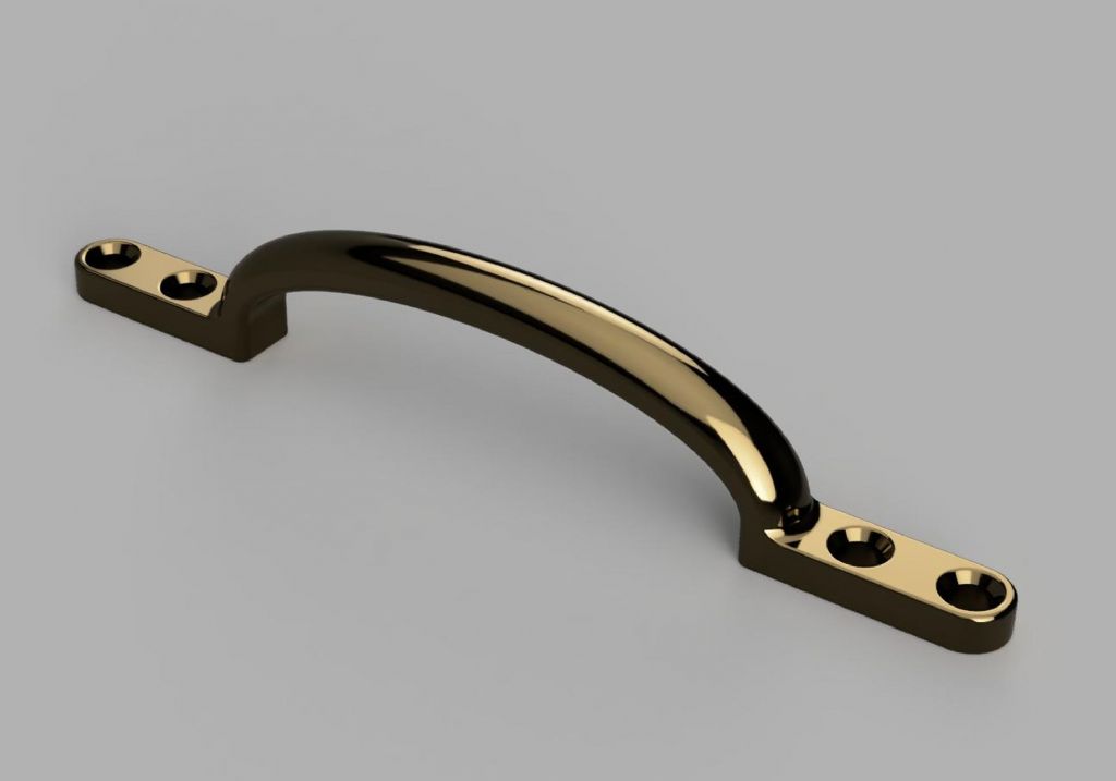

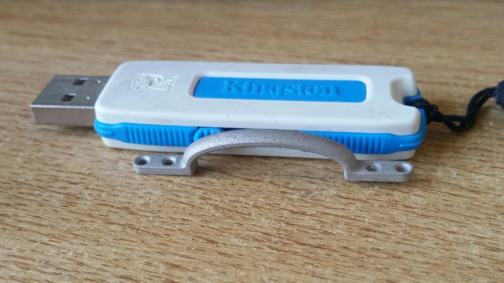

Cab window handles seen previously as a render now exist in white bronze.

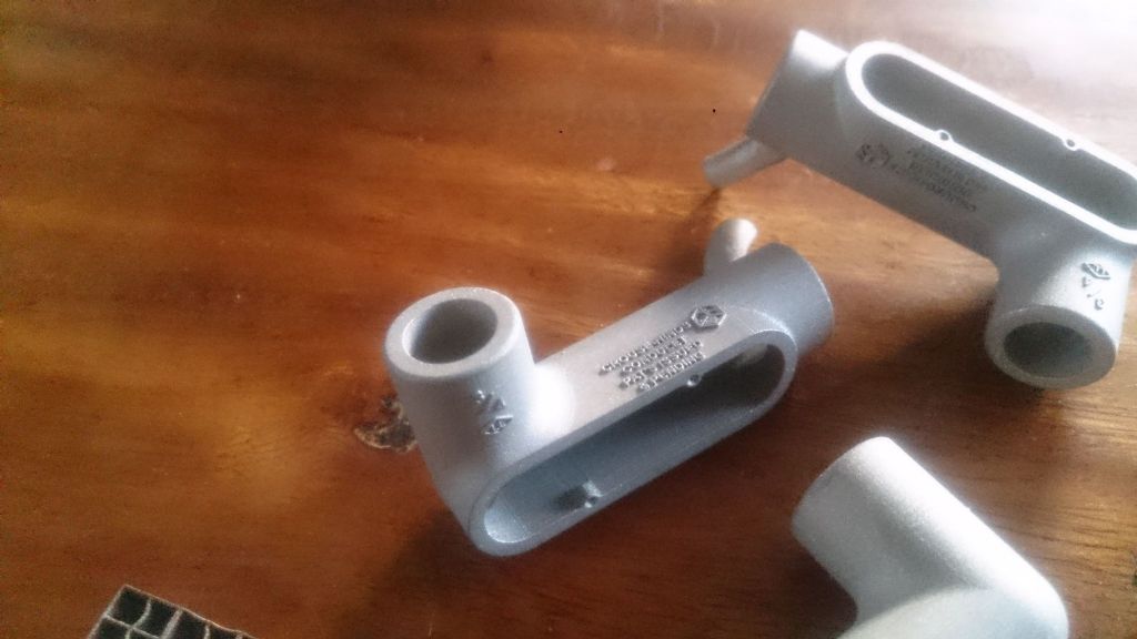

Investment castings arrived today.

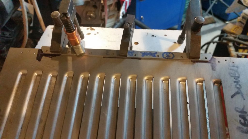

Drilling the doors for the various strips which need riveting on.

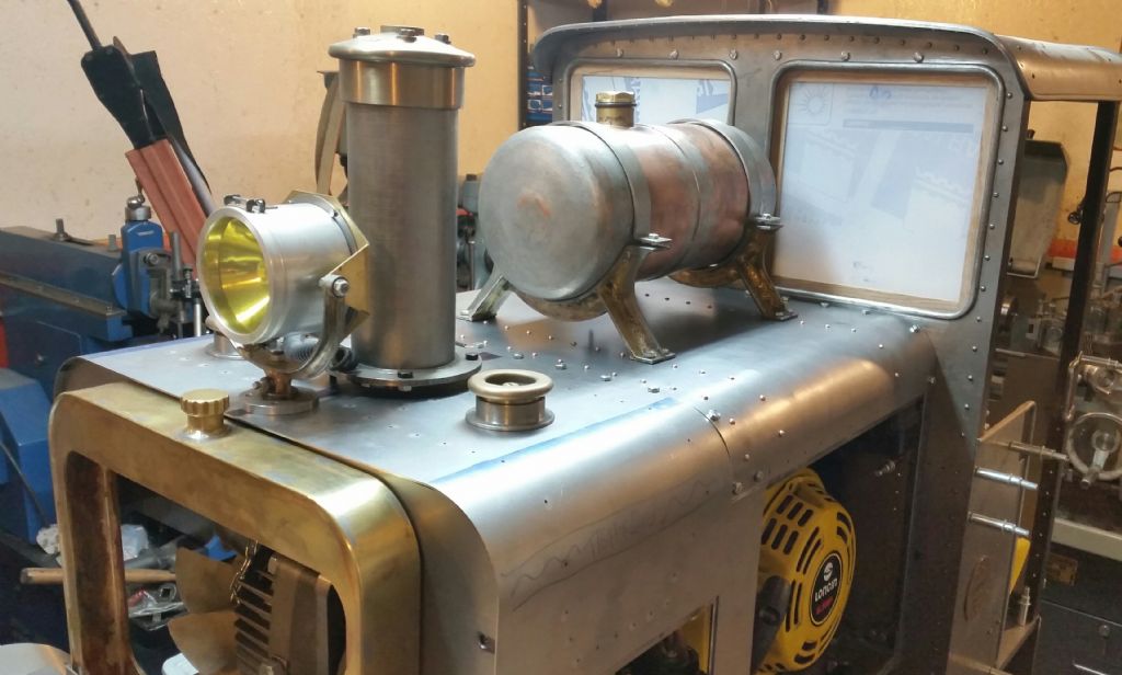

Have got a bit further over the last four weeks. The conduit castings and handles arrived today, the latter have been fitted this afternoon. A revised under chimney panel is fitted with a load of M2 button heads, along with the chimney, lamp and front sand fillers.  I was impressed with a roll forming tap used to tap the body frames under power.  Never used one before, but they're brilliant.

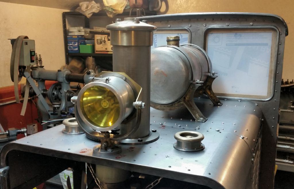

Under tank panel bolted on with all dummy rivets in, there are some button heads above the doors which are not fitted as they are in the post. The under chimney panel will be replaced as this first effort is not quite right, but you get the idea.

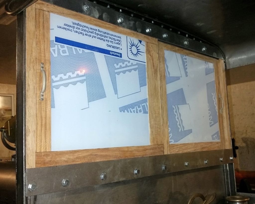

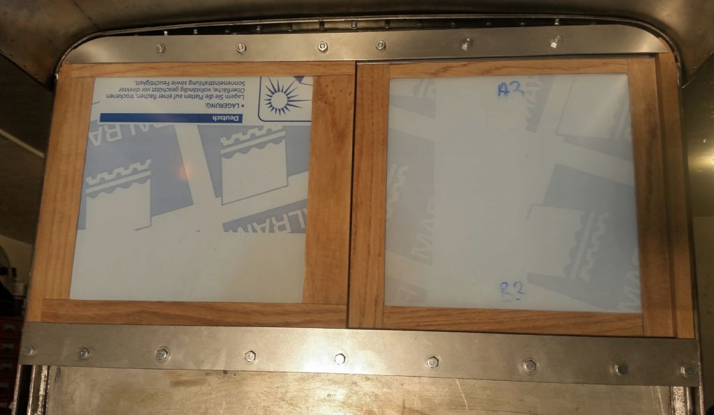

Oak cab window frames

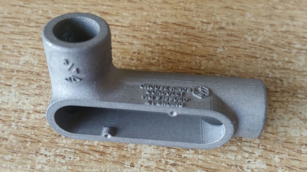

Conduit castings  They are designed to take 8mm heating pipes for the conduit.

Got a bit further with the Baldwin, namely cab windows and window handle model rendering below, the castings now exist for the conduit fittings and I'm getting on with the bodywork. The panel under the tank is now fitted.2021-02-09-10-00-52am handle v3 render.jpg

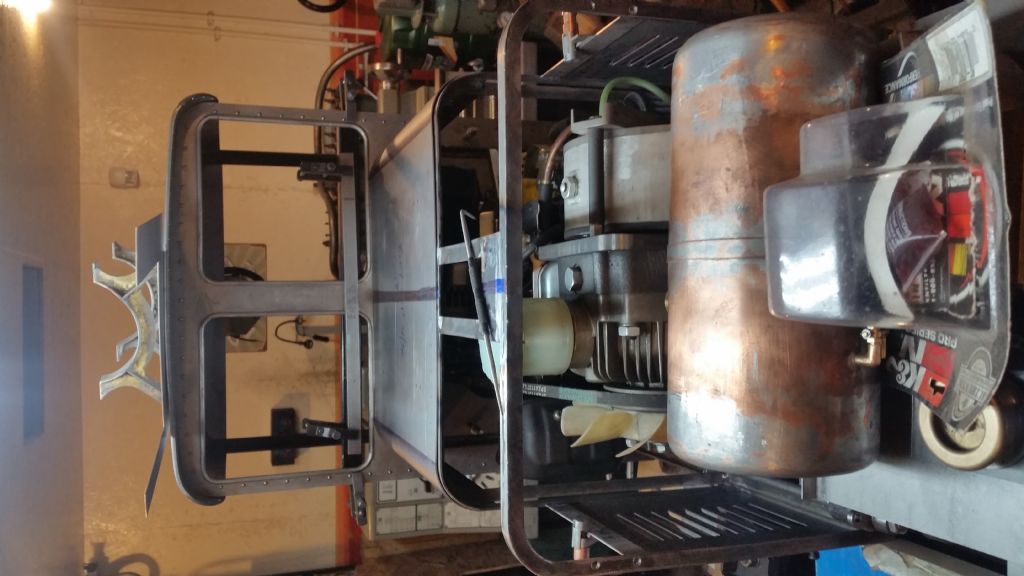

Panel bent after marking it with the centres of the bends. I don't know why it is sideways!

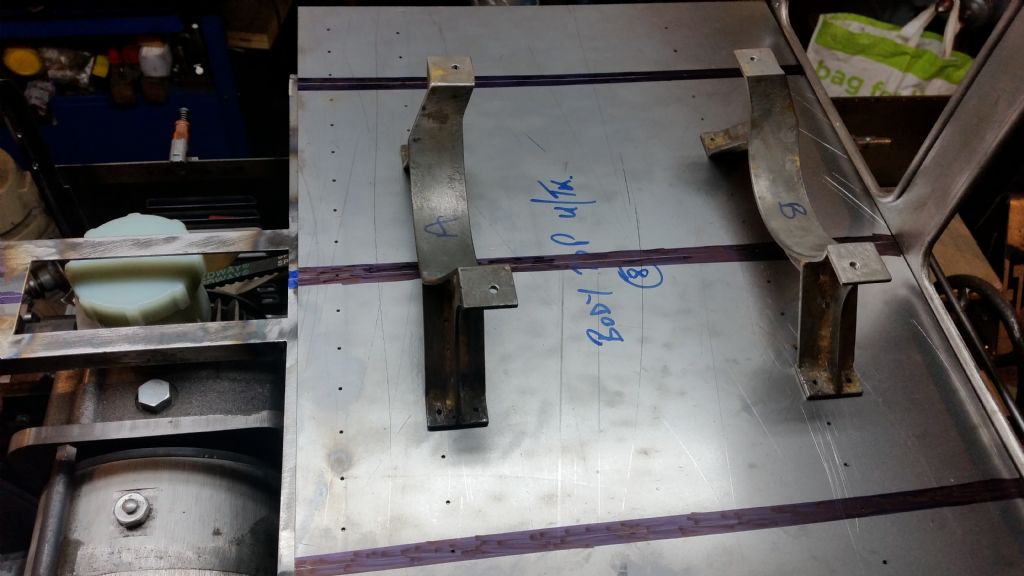

19/12/2020 18:54:21
Holes drilled in tank bracket feet. Centre lines marked on panel and body framing. The outer lines show the extent of the flat top/start of the bend.
