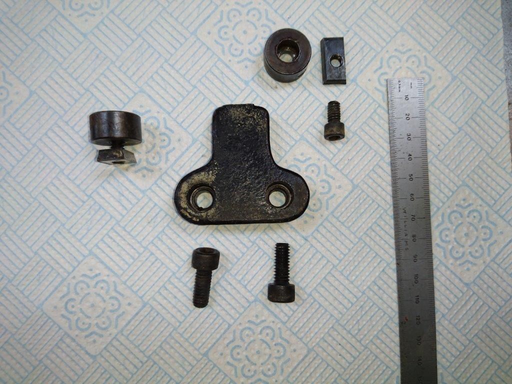

23/01/2016 15:48:24
And this is what the individual parts look like off the mill

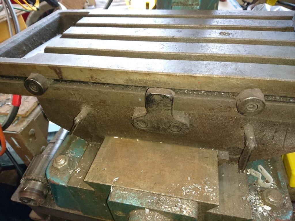

23/01/2016 15:47:43
Here is a close up of the table stop parts in situ

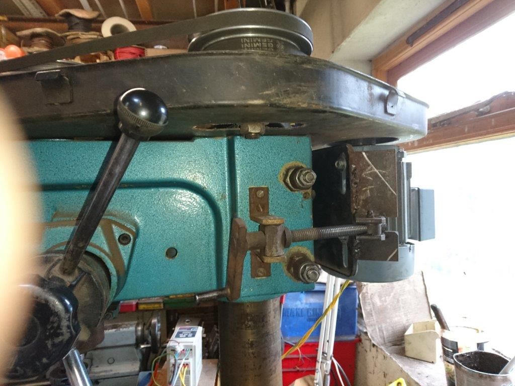

23/01/2016 15:41:33
Here's a picture of the screw operated belt tensioner. The longer column clamp bolts and packers (stacked nuts) on the right of the head stock are simply so you can get a spanner onto the clamp bolts without amputating your knuckles.

23/01/2016 13:36:54
Hi again, the other modification I did to mine fairly early in its life was to fit a screw jack to the belt tensioner. At its simplest it's just a bit of all-thread from a bracket screwed to the RHS of the head casting to a pivot welded on the side of the motor mounting plate. The motor and its mounting plate swivel on two bolts on the LHS of the head casting. Originally there was a silly sliding peg and grubscrew affair to push the motor mounting plate backwards and tighten the belt.
Quite apart from this needing at least three hands to do, one of the main advantages of a belt driven machine is to be able to set the belt tension so the drive is firm enough to turn the cutter, drill etc, but if it all goes horribly wrong the belt slips rather than breaking things. Especially useful for drilling big holes! My experience with the peg and grubscrew arrangement it was originally fitted with was it was impossible to tighten the belt enough to drive properly - it's got a 1 hp motor and if you're drilling inch and a quarter holes you need the belt tight enough to transmit the torque of the motor. Otherwise you just keep stalling the spindle and chipping the edge off the drill.
If you're interested I'll show some photo's - it's a bit crude and made by a blacksmith (and an agricultural one at that!) but you'll get the idea. If I can work out how to upload piccy's...
