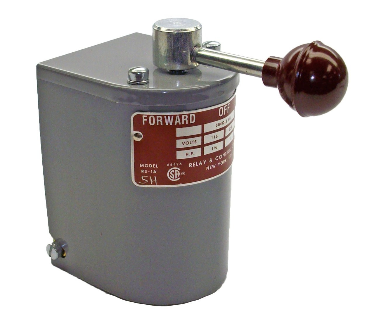

Thread: I need to move my motors contol box single phase with cap
19/02/2017 13:40:38
I have seen lots of control switches that are like a drum how do you wire one of these up please would trailer cable be any good for wiring to main box from motor please?
Currently this is wired as follows:
N -> a
R -> Mains.L
S ->Mains N
T (empty)
W -> yellow motor windings, starter capacitor. brown
V -> red motor windings, starter capacitor blue
b -> (brown into motor temp)
U-> motor blue windings , (brown to motor temp)., motor black windings goes onto lower rail onto U.
Can this be converted to run a http://www.electricmotorwarehouse.com/content/IMAGES/RS1_diagram.jpg switch that is a drum type remote please? Like this http://www.electricmotorwarehouse.com/1-5-hp-2-hp-electric-motor-reversing-drum-switch-position-maintained-rs-1-sh/#sthash.Vq4UY9jK.dpbs

Thread: Single phase reverse electrical genious required
18/02/2017 15:43:07
