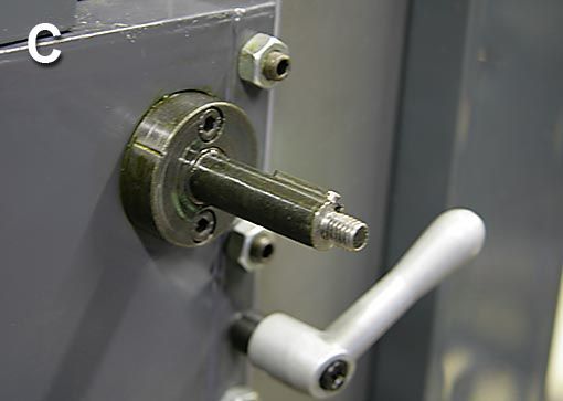

John, thanks for the feedback. From what you say it looks like I'm going to have to solve the problem of equipping my mill with some sort of a fine feed before I think of throwing any good money at boring bars.
20/11/2015 17:02:34
From what I have seen (and read) I can agree that a fine feed is required. It seems only natural that a motor-driven fine feed would produce the best results. Does fine-feeding with the little hand knob on the X2 work?
If this is sufficient it, of course, brings me around to trying to find some way to retrofit my machine with some (appropriate) gearing or mechanism to obtain the same result. frown
Given that I have only this vertical mill and a small Taig Micro lathe I am not completely certain that I can actually produce the required items to effect such a change. Or am I wrong?

Hey everyone, just a quick introduction here. I call myself Ignatz and live over here in Belgium. Just getting a bit deeper into the world of machining, but still pretty much in beginner territory. I've had a little Taig lathe for donkey's years and finally decided to take the plunge and get something to handle the milling work.
This is a small vertical mill/drill unit I purchased some weeks ago. It is a CH-10M unit, made in Taiwan and dates from 1999. It is in surprisingly good shape for its age. The motor runs well and the carbon brushes don't appear to have any appreciable wear. I also think the previous owner loved lubrication… maybe to a fault. The mill came with a fair number of end mills, reamers and such and now I am in the process of acquiring some of the necessary tooling to complete this unit.
Anyway, I have a few questions.
A) This unit does not have the optional fine feed wheel (photos B, C). This can make fine work on the Z-axis pretty iffy. I am wondering if anyone knows if a fine-feed unit can be obtained for this mill after the fact, or else, failing that, if there are any plans or write-ups online detailing the construction of one's own fine-feed system.
B) Does the CH-10M have the necessary rigidity and fineness of feed to do any boring work? If not then I would rather not waste any money on tooling for such.
C) Both of the depth readouts on the unit are pretty primitive (side scale with a pointer and that calibrated twist dial around the downfeed spindel (photo B). Any suggestions as to the best way to mount something like a dial gauge or such?
D) This unit has X-Y readouts that appear to be one single piece with the handwheel (photo D). This means you cannot roate them to zero them out, but instead have to do a lot of fussy number-math when doing any precision work. Can it be done and is it worth my time to try to refit the X-Y leadscrews with newer handwheels with the spring-loaded zero-able scales?
E) The spindle nose on this is short and the X table is made from (extruded?) aluminum (alloy?). That means that findng a place to lock down a magnetic DTI indicator base for tramming is not the easiest of tasks. Any suggestions as to the best DTI holders for this little beast?
Any advice or commentary welcome.
