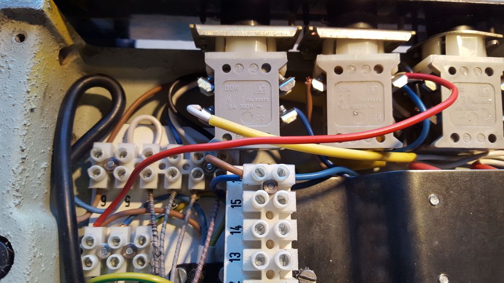

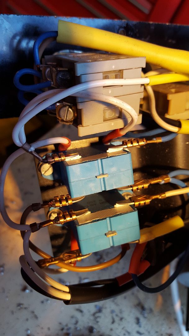

Hi All,
Got a slight problem with my Hobbymat MD64 lathe in that is stopped working yesterday. It was like I hit the stop button but it wouldn't switch on again.
There was no burning smells and the fuse was still good in the plug. Straight away I conceived myself the motor had gone bang.
After an email exchange with Essel Engineering (very helpful) I removed the motor this morning to check the centrifugal switch to discover this is a later model and doesn’t have one fitted.
So out came the multi-meter and I worked my way through the wiring and the 2 relays.
On the photo below, if I pushed in the white centre contact on the lower of 2 blue relays the motor would run.
I’ve check out both relays and they seemed to be working as they should.
Now by luck I was checking the voltage to the on/off switch but my multi-meter was set on ohms/continuity rather than voltage. As I touched one of the terminals on the off switch the lather would fire up and run.
I have now put in a bridge wire from the live terminal too the terminal on the red stop switch as can be seen on the photo below. This is the red wire.
In this condition the lathe works as it should using the on, off and direction buttons.
For obvious reason I don’t want to leave the lathe in this condition, I would rather fix it correctly. Problem is for the life of me I can’t work out what I have bridged/by past. In this condition both relays click in and work and my meter checks tell me the switches are ok.
So now I’m confused so hopefully this is where you step in and say that is so & so enlightened
Any help is most appreciated
Cheers
Steve

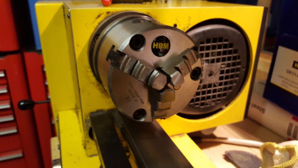

Just an update on the process so far. After a lot of web browsing, measuring and confirm my MD65 had a 56mm recess I decided to go for the 80mm HBM chuck from RDG tools. This chuck had recess of 56mm so if the PCD didn’t match all I would have to do is drill 3 new holes. This was the closest chuck I could fine.
The PCD looked pretty close to what I measured about 0.5mm out from the spec on the chuck but being a newbie I wasn’t 100% sure on my measurements.
After some super delivery from RDG the chuck was with me, so time to line it all up.
And if by magic the 3 front mounting holes line up prefect with the standard back plate. I’ve replaced the supply 50mm fixing bolts with some 60mm ones and tighten it up in place. I’ve put a dial gauge on there and the chuck is running true.
I’ve not turned anything yet but will do over the weekend.
So the chuck is a direct replacement for the standard one which is a right result. yes
So thanks to everyone for the advice, it has been most helpful.
