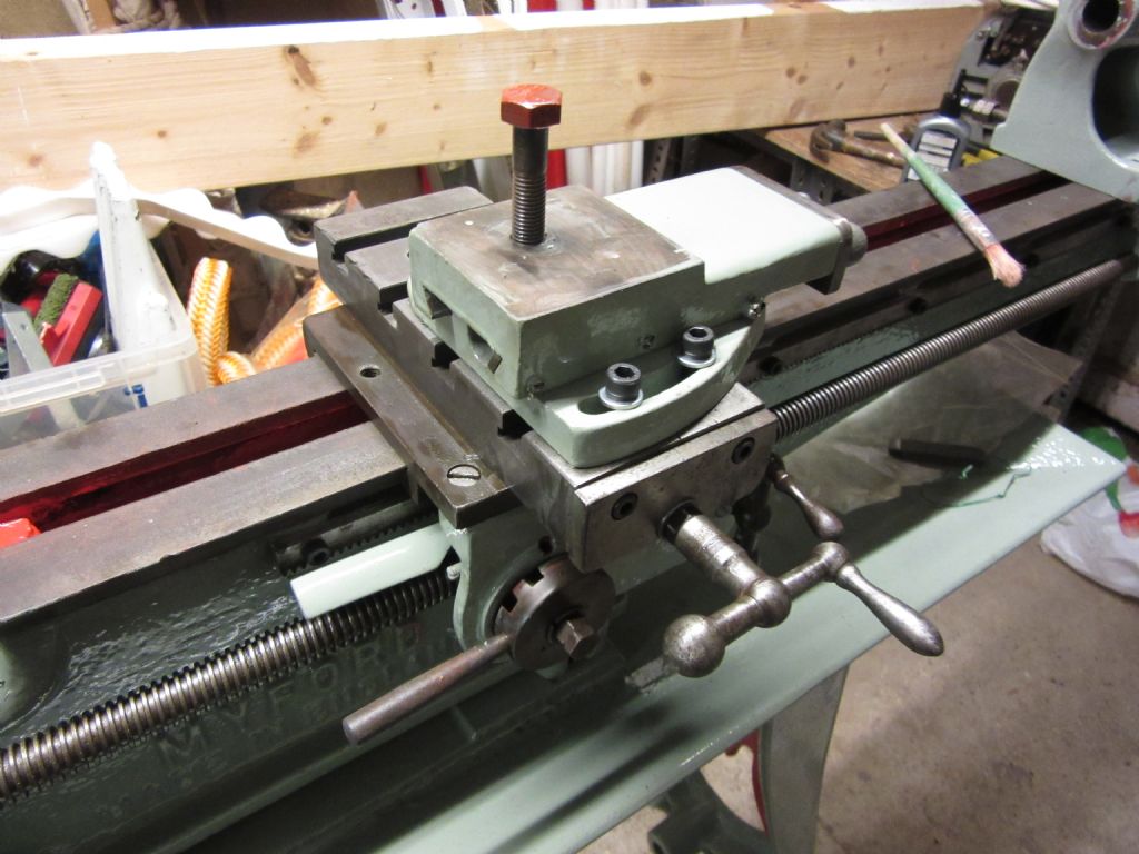

leftover2+dim.jpgIt is all back together now but I need to make up a countershaft flat belt before I can run it. I appear to have bit left over though and I don't know where it goes! I don't think it'll affect the running of the lathe though.
What will be a problem is the 3 jaw chuck, it feels as though it is full of sand and it is hard work turning the key. The scroll appears clean as are the teeth in the jaws. Any advice on dismantling and cleaning the chuck?leftover 1.jpg

saddle.jpgimg_0009.jpgimg_0004.jpgHi, thanks for input it all helps to conjure up a picture of what I have to make.saddle.jpg

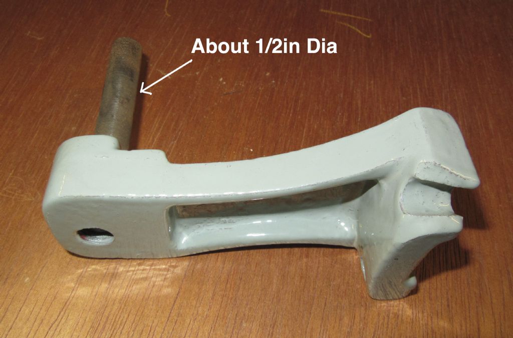

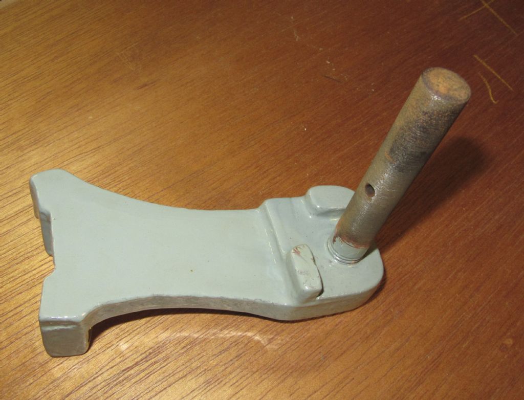

Hi, I have solved the countershaft location and fixing problem. It does go where I thought it should but I think I was looking for something more sophisticated in the fixing and adjustment line!
I have another problem now with the tailstock.
I think the lathe is an ML3 but I am not sure as there are no markings on the bed. I would like to see some pictures of the dovetail mating parts of the tailstock to the bed that probably fix to the offside of the tailstock and are similar to those on the nearside of the tailstock. I reckon I am in for some copious filing and hacksawing but I’d like to see what the manufactures parts looked like before I start grafting. I appreciate that the tailstock lock is on that side and is probably simply a made up nut fitted with a lever that fits on the protruding stud shown in the picture. If anyone has a model similar to the pictures of mine I really would appreciate a view of your tailstock clamping and slide-way parts and perhaps a suggestion as to the model type. I will read the instructions on creating an album and upload some pictures
Many thanks, Don

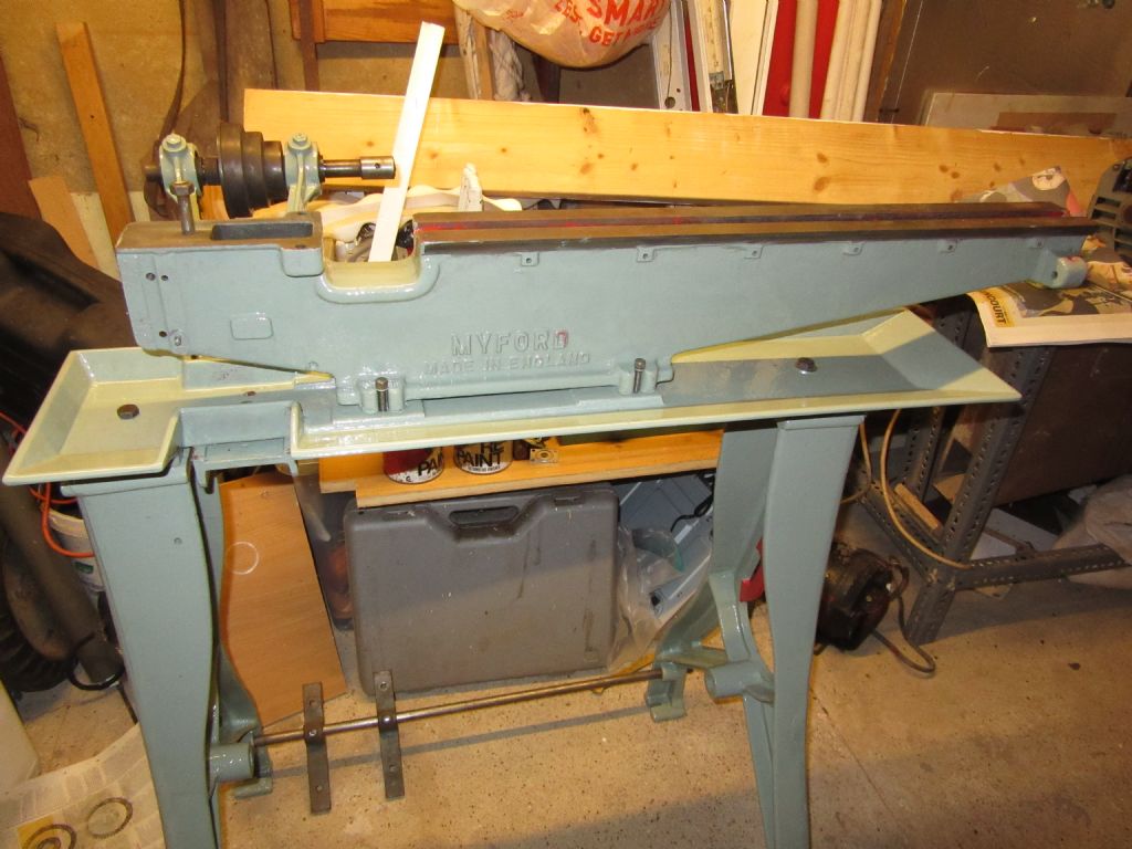

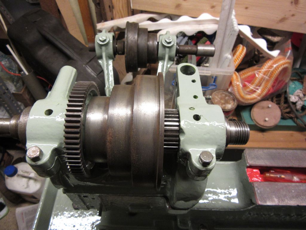

31/10/2015 19:16:11
Hi, I am trying to restore an old Myford lathe I dismantled 15 to 20 years ago. I believe it is an ML2 or ML4. Unfortunately I did not take any photos at the time of dismantling! Luckily, not typical of me, I stored all the bits safely and now after cleaning, repairing and painting I am trying to rebuild the machine. Even after studying old pictures of the machine I cannot locate and secure the counter-shaft with the three flat belt speed change pulleys and the pulley that links to the motor.
The obvious spot does not seem right to me. There are two 3/8in holes in the tray but only a square hole in the bracket. There are two further 1/4in BSW holes in the bracket that don’t seem to line-up with anything on the tray or headstock. Have I in fact lost a packing piece that fits between the ribs on the underside of the tray and does a bolt go through the rectangular hole to hold the bracket in place?Hi, I am trying to restore an old Myford lathe I dismantled 15 to 20 years ago. I believe it is an ML2 or ML4. Unfortunately I did not take any photos at the time of dismantling! Luckily, not typical of me, I stored all the bits safely and now after cleaning, repairing and painting I am trying to rebuild the machine. Even after studying old pictures of the machine I cannot locate and secure the counter-shaft with the three flat belt speed change pulleys and the pulley that links to the motor.
The obvious spot does not seem right to me. There are two 3/8in holes in the tray but only a square hole in the bracket. There are two further 1/4in BSW holes, A and B, in the bracket that don’t seem to line-up with anything on the tray or headstock. Have I in fact lost a packing piece that fits between the ribs on the underside of the tray and does a bolt go through the rectangular hole to hold the bracket in place? I had hoped to attach some pictures to this post. Can someone explain how this bracket is secured?
