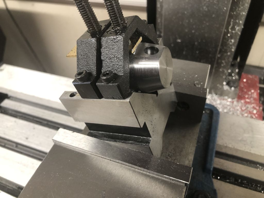

01/12/2018 11:54:11
I got a few hours in the workshop yesterday and today, got the slide nut for the vice jaw to the point it now needs the lead screw hole drilling and tapping. I’ve come up with a plan for getting it in the right place - more on that when I get to it.
I also got set up and screwcut the threads on the lathe for the slide bar.
Excuse the mess on the bench...
Cheers
Mark
28/11/2018 20:21:05
I managed a half hour this evening. Got the fixed jaw locking device finished and the ends rounded off so that it fits the slot in the bottom of the vice riser. Photos show better than words.
I’m not overly happy with the finish on the riser block, but as it’s to dimensions, I’m going to leave it as is, as a reminder to me of my first attempt at fly cutting. It will add to the character😂
With the vice jaw on and just held together, I can get a .15mm feeler guage between. I’m hoping that will be enough to nip it down.
I also got the tool post handle loctited into the nut and on the lathe.
Cheers
Mark
