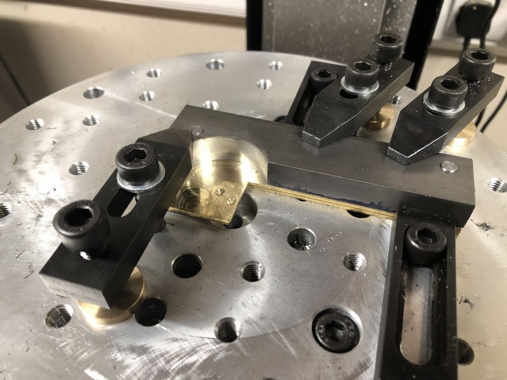

Tonight I’ve got all of the radiused ends done on both arms.
Here is my method of centering parts. I turned up a central spigot, as the locating holes in the arms were 6mm, it’s really just a 20mm extra thick washer reamed 6mm in the centre. I also turned up a 6mm silver steel rod with a point.
With the part free to move and the pointer chucked up in a collet, the pointer was fed through and located in the spigot, then the arm was clamped down and a 6mm screw is fed through the centre of the table and threads into the MT2 stub arbour that the sub-plate locates on.
It all worked a treat and I’m happy with the results.

10/12/2018 21:56:18
I made a start on the ends tonight, changed the vice out for the rotary table... again... and got set up. I’m going to take it down to .25mm with the rougher then take the last bit with an end mill and see how that works out.
Cheers

10/12/2018 18:21:07
After the success with boring the 5/8” hole between the 2 arms, today I decided to use a sacrificial piece of steel to bore the 5/8” hole on the top arm. I made up a 5/8” brass plug to gauge size. I really need to get a set of bore gauges.
I also got the bottom arm drilled and reamed out 1/4”
After using the bore gauge, i used part of it to make a centre for my fixture plate, just a plain centre, drilled and reamed 6mm for use on the next operation, rounding off the ends of the arms.

08/12/2018 21:02:00
Inside done, set up and milled the outside, I ended up taking 1mm at a time, the table seems secure, although, the backlash in the RT makes climb milling ‘interesting’. I ended up taking .1 mm climb with the table locks nipped down to finish off and it worked out ok.

08/12/2018 16:44:02
Thanks Gents👍
I have got all set up on the table and started milling out the ends of the arms:
I’m just nibbling .25mm at a time off as this is the first test of the fixture plate and clamping system.
