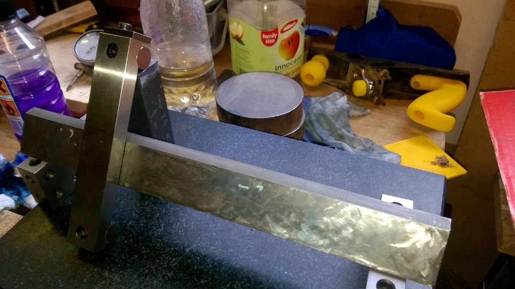

After months of stumblings, I've finally done something constructive enough to post on here!
Following advice in another thread, I've invested in a sine bar to check the angle of my prism. A back of the spreadsheet calculation showed that the height needed to be 104.03mm.
So I've milled, filed and scraped a piece of steel to be 104.03 mm as the riser for the sine bar. That is assuming my height gauge is accurate, which I can't check.
Actually, the top varies by +0.01 / -0.02 mm or so, but for something made with my own fair hands I regard this as the ultimate in precision! That would put the angle out by something like 2% of a degree. Far better than I can work to!
Next step is to actually check and correct the angle. Well next but one; I'm still working on getting the base flat. I currently on scrape 180 and counting. I expect I'm doing something wrong for it to take so much work, but no doubt I'll get there!
Next time I try something like this I'll try and find a bit of cast. scraping mild steel is rather more difficult.

I'm in the process of making an accurate 55 degree prism, partly for the purposes of trimming up my micro mill dovetails, but mainly for the fun of it.
I've got the two surfaces scraped to the point where they are reasonably flat, but nowhere near bearing quality.
Before I put the finishing touches on it I want to get the angle accurate. I have a Lidl angle measuring tool which reckons it's a 0.1 / 0.2 degrees out, but it's quite hard to take an accurate measurement.
to be fair 0.1 degree out is more than adequate for the micro mill, but I'm treating this as an exercise is precision to see what I can overcome my natural hamfistedness.
According to my back of an excel spreadsheet calculations, if I take a point 15mm in from the sharp bit, at 55 degrees it should be 21.422mm high. at 54.9 degrees it is .08mm (3 thou) lower and at 54.8 degrees .16mm lower.
Of course the edge is not knife sharp (I've softened it, to stop chipping) and I'm not sure how I would measure from it in any case.
