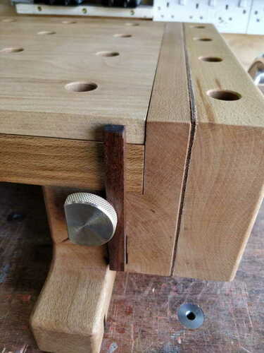

This is a project that is more for woodwork than metalwork, but it involved a lot more metalwork than woodwork, so I thought it might be of interest to some people on this forum. Pictures of all the metalworking stages of the build (turning/milling/welding of lots of parts) are in the build log, link below.
It is a portable workbench, used for clamping wood higher up than I can with the vice built in to the main workbench. Apart from the 160 mm diameter aluminium hand-wheels and some basic hardware, everything was home-made. The quick-release vice mechanisms allow the vice jaws to be slid open easily once the hand-wheels have been turned about half-a-turn anticlockwise and then they re-engage the thread when turned clockwise.
The vice jaws are 380 mm wide and the moving jaws are coated in leather to improve the grip.
The bench is made out of beech and American black walnut; the mechanisms and other moving parts are steel and the bearings & bushes are brass.
The dual-screw vice allows vertical clamping of stock up to 200 mm wide and also clamping tapered stock. Both sets of jaws open to a maximum of about 300 mm.

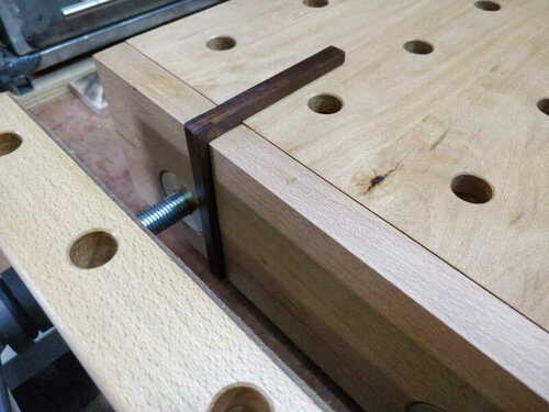

There's also a little edge guide that fits into a 12 mm slot in the fixed jaw of the dual-screw vice. This allows two pieces (one vertical and one lying on the bench top) to be aligned with their edges in the same position, which is useful for marking out the pins when cutting dovetails.
The dovetail guide has a storage slot in the side of the bench with a brass clamp to hold it in place but make it very easy to remove (by turning the clamp 180° anticlockwise).
