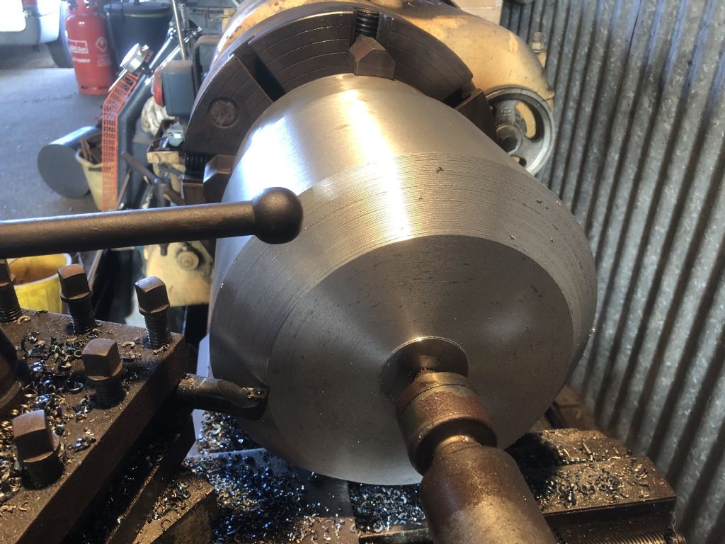

I made two of these from 300mm material and they took 3 days each. The third was made from 150mm material and took about 6 hours!! The 300mm material weighed approx 166 Kg each and the swarf weighs about 120Kg.
They are to hold up a balcony on a house. A 50mm round bar goes in the hole and the spigot on the opposite end of the cone goes inside a 10" pipe so when complete it looks like the balcony is supported on nothing! Architects for you.

Of course all the photos have posted last first and first last......The smaller piece of material is 150mm in diameter.

img_1382.jpgimg_1367.jpgimg_1364.jpgimg_1361.jpgimg_1360.jpgimg_1349.jpgHi Chaps, its been a while...........
However, I am uploading some pictures of my 17" Covmac working....yes actually working! The material is 300mm x 300mm bright steel. Technically this doesnt fit in the lathe over the saddle so I had to do some lathe jiggery pokery to actually machine it. You may be able to see the clearance achieved over the saddle with the finished outside diameter. The lighter on the tool post is for comparison and the last picture is self explanatory, I hope.img_1348.jpg

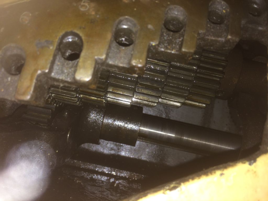

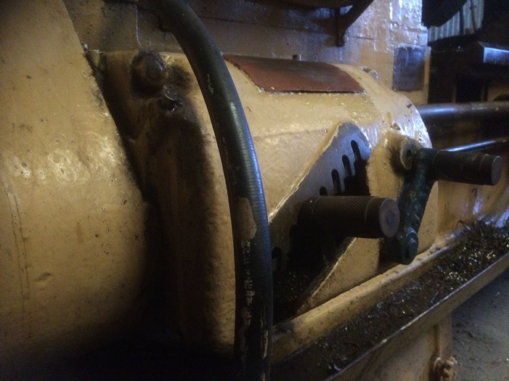

Hello Brian, here is a photo of the screw cutting / feed ratios, you may need to zoom in to read it all. I am afraid I forgot to take a couple of the gearbox so will do that after Easter. There is no metric table inside the gear cover.

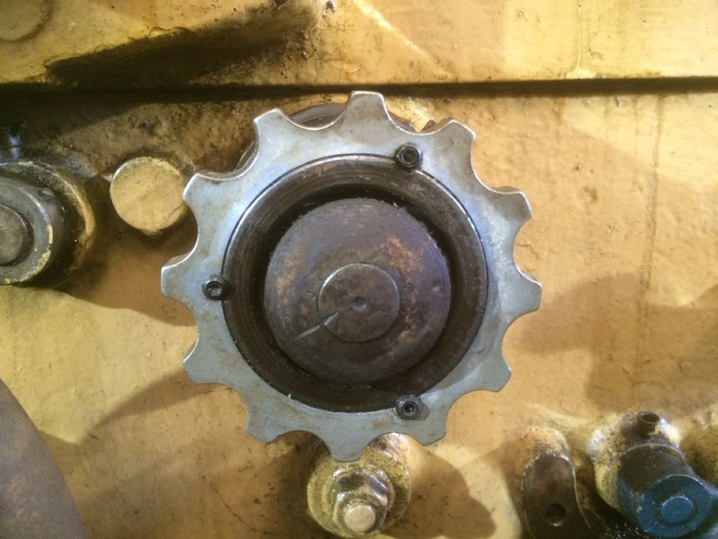

Chris: No, I have never had it apart and I believe that the original colour was an off white. The current colour is called buff and was applied about 30 odd years ago by the previous owner. The surface/sliding knob is a modification made by the owner before the previous one. It is really handy as sometimes the knob can be quite hard to turn once the load has been on it for a bit. Pic to follow.

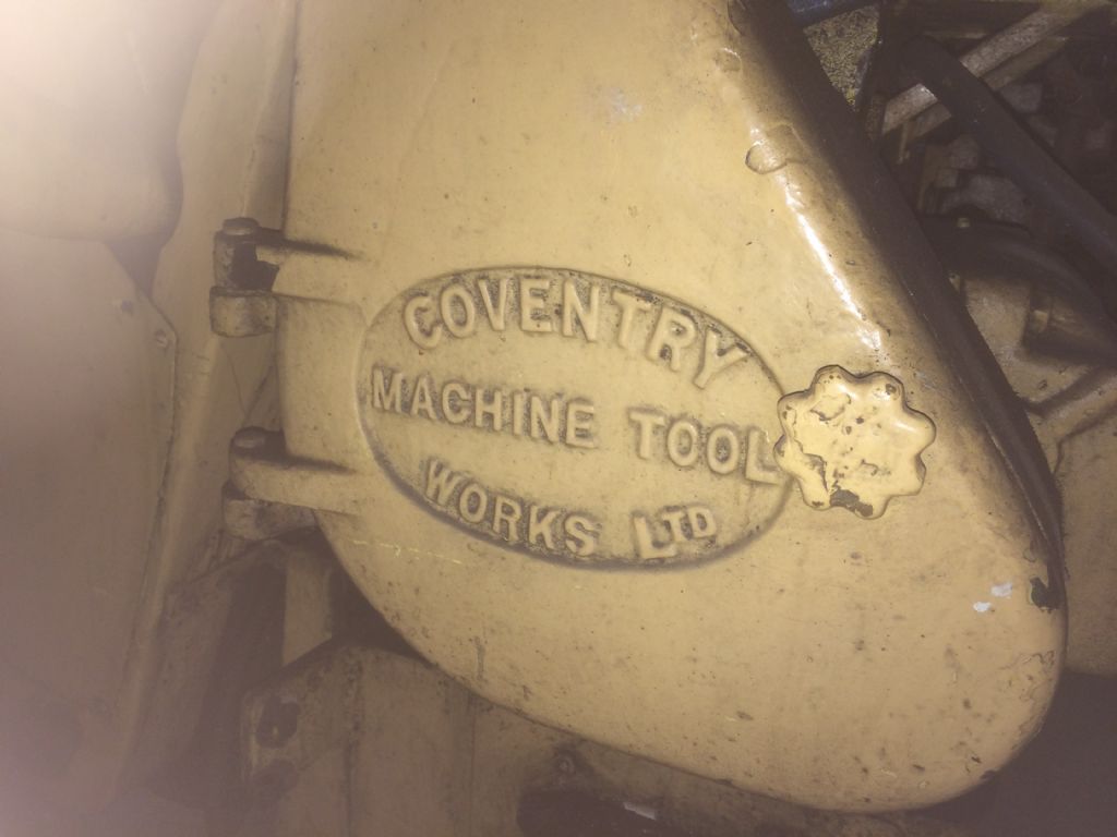

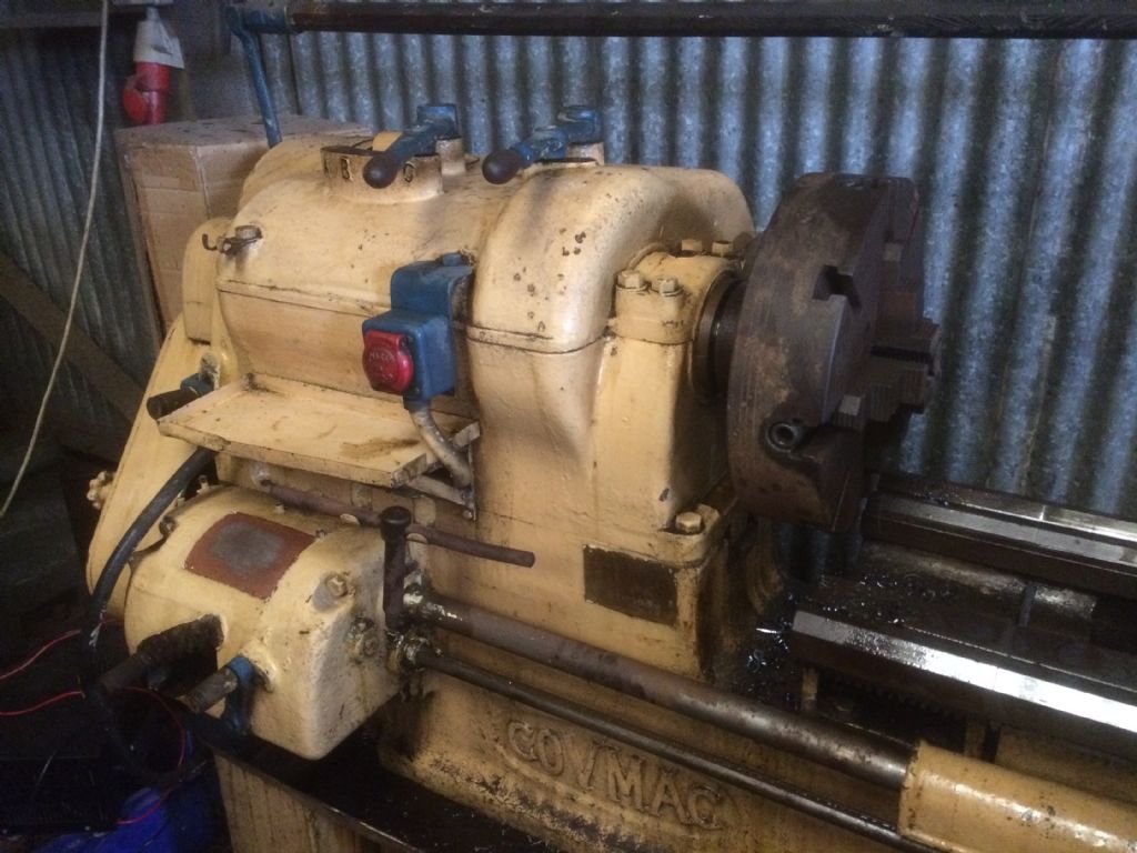

img_0337.jpgimg_0336.jpgimg_0335.jpgimg_0334.jpgimg_0333.jpgimg_0327.jpgHello Everyone,
I have read this thread with interest. I have to admit that my main interest is that I would appear to own one of the THREE remaining 17" Covmac Lathes. Mine was built by D & J Tullis Ltd of Glasgow and is fitted with the usual "war finish" plaque.
Here come the pics...................
