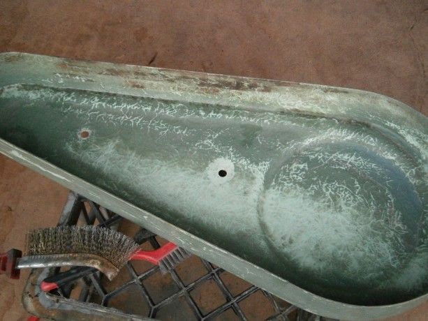

I have used degreaser and scourer, nylon bush, repeatedly, tried a wire brush but that was to aggressive.
How would you remove it?

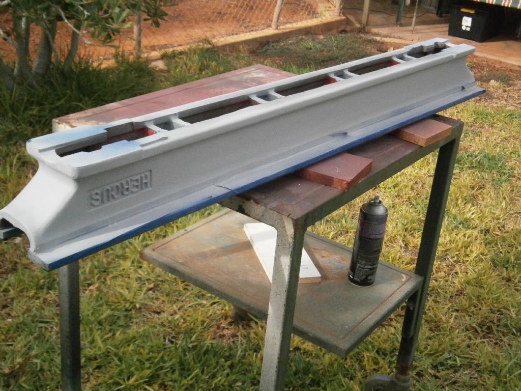

08/04/2020 10:25:07
Had a few attempts with the the car bog never used it before, finally got it right
There was a few holes in the name so started to scrap it out eventually removed the lot.
Raped up ready to paint
Note the name

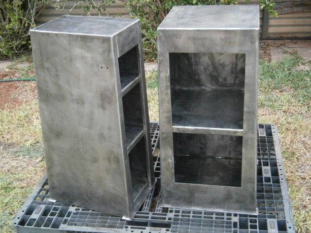

Now that I am in gaol I have be getting back into my Hercus, before I came home Bunnings and car accessories places had mobs of empty shelves, managed to get the last two tins of spray putty and the last tin of car putty.
After giving the cabinet and tray a citric bath, went over them with a wire brush on my angle grinder.
Asked some one to get me a tin of Killrust Etch Primer.

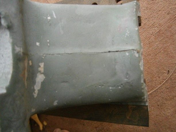

p2270497.jpgp2270498.jpgNow that I have the big parts of the bead and head stock cleaned up with citric acid, what would you do with cracks and holes in the bog?
I have a can if spray bog the will cover the small crazing cracks in the third photo, should I get a can of car panel bog to fix the damage?p2270499.jpg

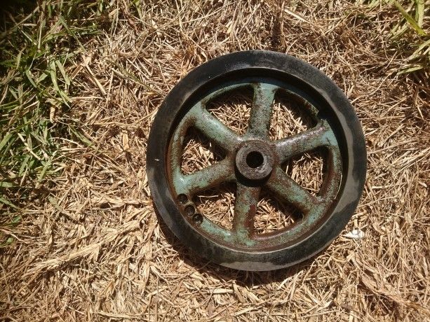

I have been blowing them off with my air compressor, then let them sit in the sun. 15 or 20 miniutes in the mid afternoon sun picked up on part of the vice and burnt my hands,secret the other bit I left till after dark.
