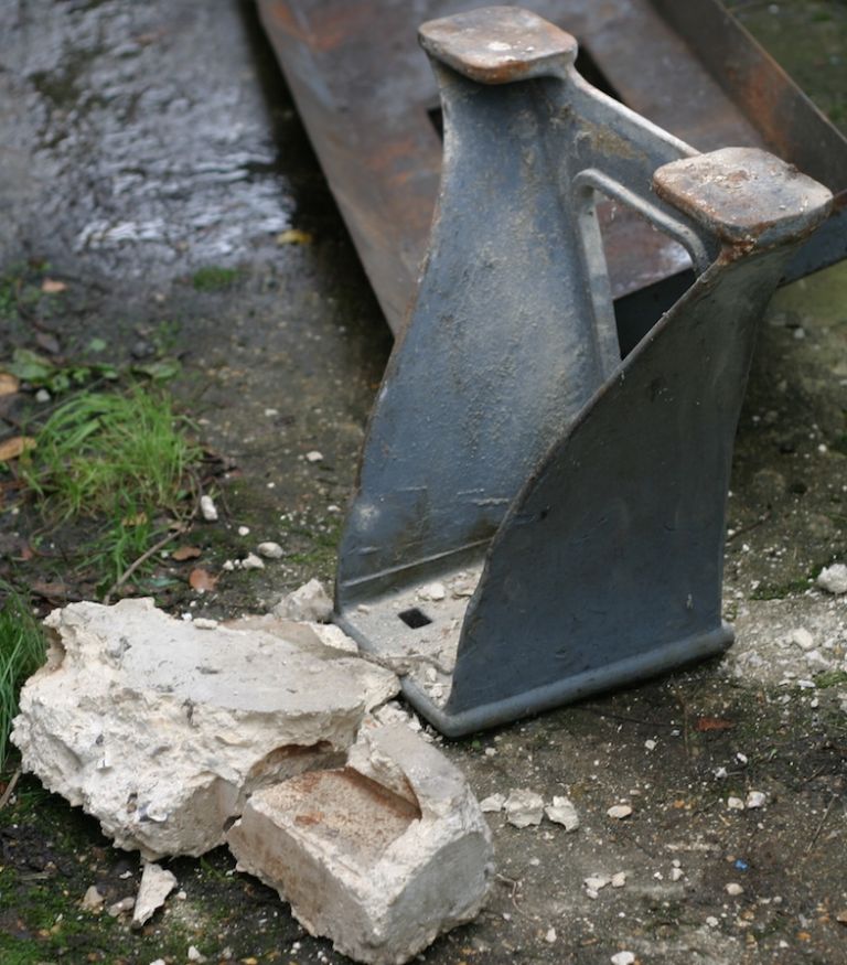

Finally, some real progress on moving my CovMac from Southampton - the job was badly delayed by tailstock legs being deeply concreted into the floor - shown above. Basically, the previous owner had compensated for a fall in levels in his shed by placing its tailstock legs into a broad, shuttered bath of raised concrete. And it was a very solid and heavy mix of concrete.
I scratched my head, and pondered my own innermost futility, on two visits, messed about with hammers and chisels, and hardly dented the problem.
This was not successfully approached until I had full faith in my engine crane of 2 tons capacity.
Trying to free the legs, with weight of lathe bed still on them was just impossible. Access was very limited, and the drip tray was much in the way. It was not until I had removed the headstock, and came to shackle the crane up for a test lift of the main bed, and I had not to lift the bed by much, to have the sheer weight of  tailstock legs actually free themselves from the ground - (I think they weigh over 100 lbs - I could only just carry them to my car). I tumbled them out backwards.
This was a great leap forward. I enclose shots of the culprit. Once out of the ground, the concrete was simply knocked off with a lump hammer. It was such a huge problem in situ. It was very easy once out of the ground.
The big move is due next week. I will post many more pictures, when I have them downloaded from my camera phone.

Plinth is de-concreted, but tailstock end is harder: Beneath a concrete fillet lies a series of loose bricks - the tailstock end is higher, and the lathe's feet are about 2 inches off the floor of the shed.
The lathe will have to be jacked at that end before completing it. I did not want it to drop two inches by overdoing it.
