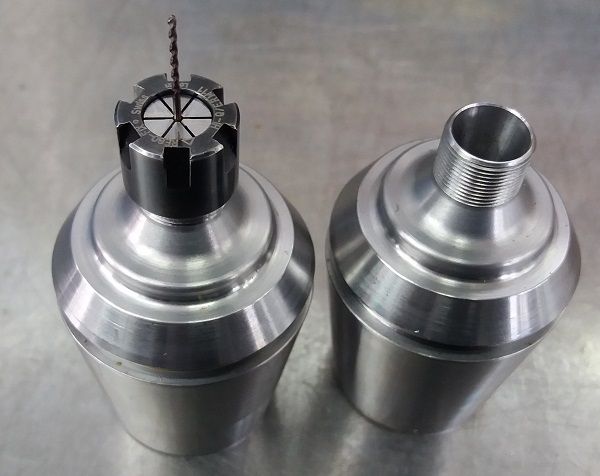

Thread: Pros and Cons of the ER collet system
24/09/2016 21:33:47
Ray, with the ER series for work holding , you can make a set of collets that are only split in the front only. These will hold work pieces without needing a support ring in the back. But are only really any good for a small holding range. From size to about 0.05mm on diameter smaller. It will keep a concentricity of 0.01mm. The other option is to use a collet size bigger than you need and then make a series of split sleeves to hold the parts. The sleeve only needs to have a single slit and depending on the length of part the slit may only need to go 1/2 way to 3/4 down the sleeve.
In my experience with the Hardinge style C collets, they only are any good at size and up to 0.05mm smaller than nominal. At 0.1mm under nominal, they don't hold parts to better 0.01mm . The C series collets , they make blank collets in steel and Delrin. These come with 3 pins for boring to a particular size and geometry required. They are a lot more work to make in the home workshop compared to the simple ER series collets. Orientated collets when bored in position will be as accurate as you can achieve on your machine.

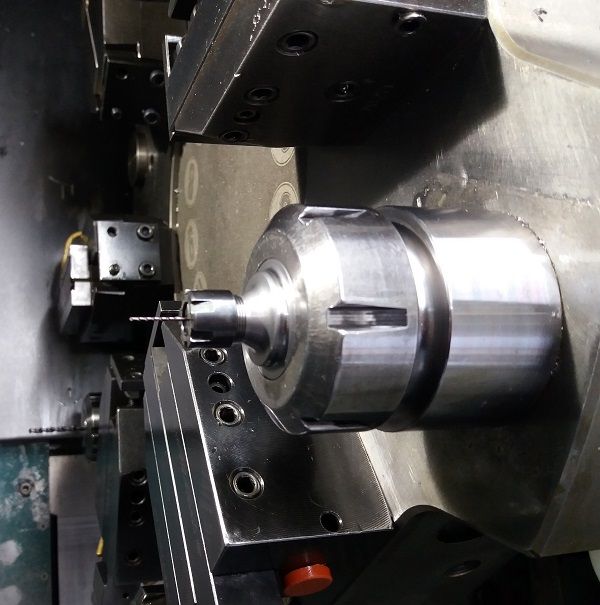

Hi John, Only the ER11 with the castle nut collet , has the front of the collet face recessed relative to the front of the collet nut. The regular or standard ER11 nut which is a larger thread on the collet holder, and uses a Hex nut design similar to ER16, 20,25,32, all are about flush or close to flush on the nose. This slim series nut came from some milling extensions that used ER11 collets on a 16mm shaft for getting down into moulding cavities. So when I made the tooling for the lathe just used the same nuts from the milling section. They also have a complete set of collets spare as well, so was a win for me. On the set ups I use, the parts generally indicate to better than 0.02mm TIR. The home made collets for specific jobs are better than 0.01mm tir and for most things that is plenty good enough. Most of the collet chuck bodies I have made are from stress relieved pre hardened P20 die steel, it is about 30Rc or so in Hardness. It is a very stable material and I feel that is very important factor in making tooling that it is a stable material. My home made cue lathe is made with an ER40 collet spindle that I made as a cartridge spindle and then mounted that cartridge onto the lathe bed. I also made various steady rests that also use the ER40 collet size and those used a 40X62 bearing from air conditioning clutches in cars. A really nice double row bearing. Other ones just used a pair of bearings but spaced as if they were angular contact bearings. I have pictures in my album on them. I also have alot of split sleeves for holding parts, so I for example a series of sleeves that are 19mm od with varying id's from 16mm down to 14mm. These sleeves are quite a neat fit onto the part and the collet is used in its nominal size range, ie from 19.05 down to 18.95 mm. The concentric sleeves are really easy to make and can be made from what ever material it needs to be, so can be steel, plastic or even wood, like I use on the pool cues. The sleeves can also have tapers to match that of the part being held like a cue where they have some quite shallow tapers for example. There is a huge list of things you can do with theses collet systems apart from just holding cutters and do it quite repeatably and with just basic lathe skills and a hacksaw.
19/09/2016 20:21:40
The lathe is a 19 year old Nakamura lathe ,71mm spindle bore, with their LucBei software on a Fanuc control. I also have made ER16 to ER11 for my cnc router at home. I really like the ER system, especially the ease at making special sized collets. On the smaller ones, I ruf them out and drill/bore /ream the holes and for the final finishing, do that between centres on the hole that was created to finish the outer front 30deg and rear 8 deg tapers. I do this on the collet sizes smaller than 4mm. I always slit them last if they are collets.

19/09/2016 01:34:28
Raymond, I put a piece inside the collet that is about 0.01mm smaller than the bored collet. I just cut them slowly with a slitting saw on the cuter grinder, so not milled. Then debur them. I also make adapters from the ER40 to ER11 for holding 1mm drills etc. I also use them in the collet chuck when holding small parts, less than 6mm diameter. I wish that I had live tooling but it just has a 12 station VDI 50 turret, 6 outer and 6 inner.
18/09/2016 11:20:08
The collet blank is just from P20 tool steel. I put in 4 slits from the front to about 4mm from the back. Most times the parts are better than 0.02mm diameter and the 4 way slit is good enough. If more range is needed, I add 4 slits from the back and finish at the retract groove. The blackened collet chuck body, sits into 50mm bored softjaws that are torqued to 90NM on the M12 capscrews to keep it all the same. The hydraulic chuck pressure is set to #10 of 24. It was bored and threaded in the softjaws when it was made. It has dedicated softjaws and is always set in the same radial position. A really important and often over looked aspect of the chuck body is the concentricity of the outer thread for the nut and the 8 deg bored taper. If these are out, it will not work as well as when it is actually concentric. I make the thread to be quite a neat fit to the nut that is going to be used and only use the one bearing nut in this case, as it is used to hold parts and not cutters.
The plate sitting on the nut is the standard stop and can be used with the tube as an extension needing greater than 25mm diameter but less than 30mm. The cap-tube is the standard extension that takes 25mm diameter stop blanks and can be used with the other tube as an extra 75mm extension to the cap-tube.

18/09/2016 08:07:32
er40-collet-chuck-with-end-stops-1.jpgThis is what I made for holding various parts at work. I make support pieces to support the collet at the back end, either as a button or as a combined end stop and collet support. For some jobs I make a collet specific to that part with a step in it or what it needs. The outer shape of the ER40 blanks is a standard program in the lathe, so just need to edit the ID detail. These normally work over a small part size range, less than 0.1mm variation. I have also made some Delrin solid colets, and use them as distortion collets. The part neatly slides into the plastic with an end stop on the collet chuck body. So makes it into a dead length set up. Then the plastic distorts and holds the part nicely. With a steel step collet and stop I can hold and second op some quite thin parts down to about 1mm thick. Neil
