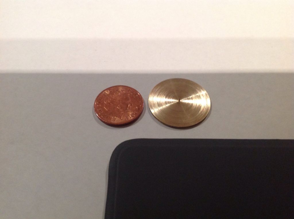

05/04/2014 23:40:41
image.jpgGentlemen,
I've used a combination of less speed (a really slow feed rate) and an angle on the left side of the tool to overcome my problem. I am still left with a slight pip but it's nothing compared to what was getting.
Thank you.
Tom
