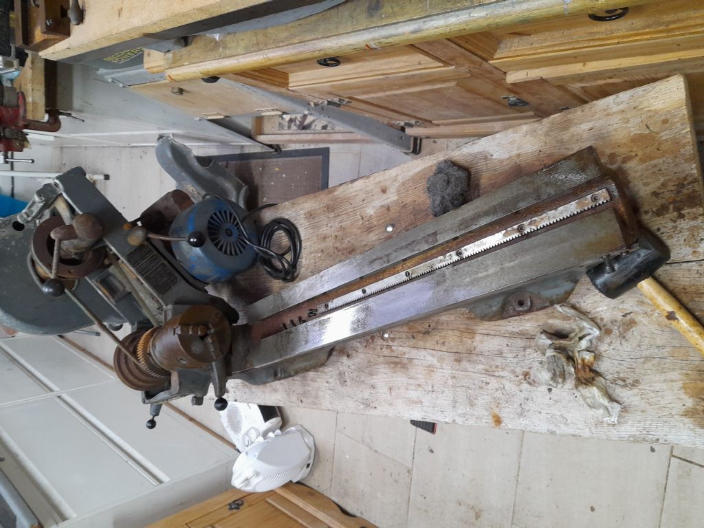

Dear All....
Sorry about the delay in getting back to the forum but a few distractions kept me from getting on with it...however hopefully I can now resume where I left off.
As you can imagine the lathe is quite heavy and I think I mentioned previously that I used a wheeled motor cycle lifter fitted with stout planking in order to move the heavy lump around and for lifting the bed so that it lay parallel to the surface plate which enabled me to roll the lump over onto the blued plate to check for flatness.

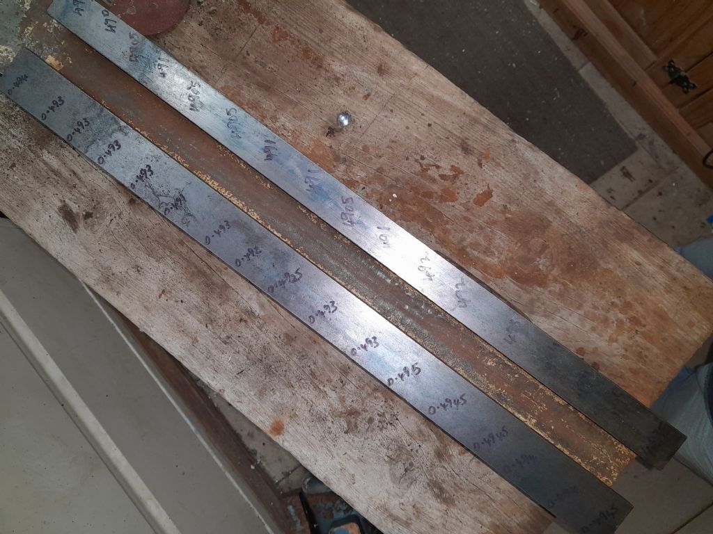

As a first check I used a precision rule to see where the wear on the shears was worst, laying the rule along the whole length showed that a dip occurred on the front shear around 10 inches from the headstock, the total difference in thickness was about 5 thou, this would cause problems with the saddle movement along the bed.
I would have had the bed re-ground but the cost was rather steep, my idea was to manually scrape the bed taking off only the absolute minimum of metal and if I made a pigs ear of it I could at least have it ground. At this point I have to admit that my skill level in scraping is not fantastic and I make no apologies for those who are determined perfectionists.
The idea behind scraping is that not only does it produce a good flat surface but it also provides hollows where minute quantities of oil can collect; if you have never done any scraping it is a good idea to have a look at u-tube videos and practice first before going for it.
The Utube video by Stephan Gottswinter is quite good and there are a number of articles on scraping in the Forum, which are useful albeit some members think its not worth it, too difficult, and not as good as grinding, and needs quite a lot of time and patience.
I would say that there is some truth in this but it depends on how skilful you are and whether you are looking for perfection; my opinion is that even if there are some discrepancies in the bed accuracy with amateur scraping this will soon be evident when the saddle is moved along the bed, if there is no lateral or vertical displacement when put in any position along the bed with no tight spots, I really think you are on to a winner.
I will also mention the articles in ME by Graham Sadler which provide some interesting methods in this area of Myford restoration.
The width separating the bed shears also needs to checked and the inner surface of the far shear provides a good datum for checking this.
So some pics of the process...
Bed de-rusted.
Checking bed thicknes.
Some more pics to follow in next post.
