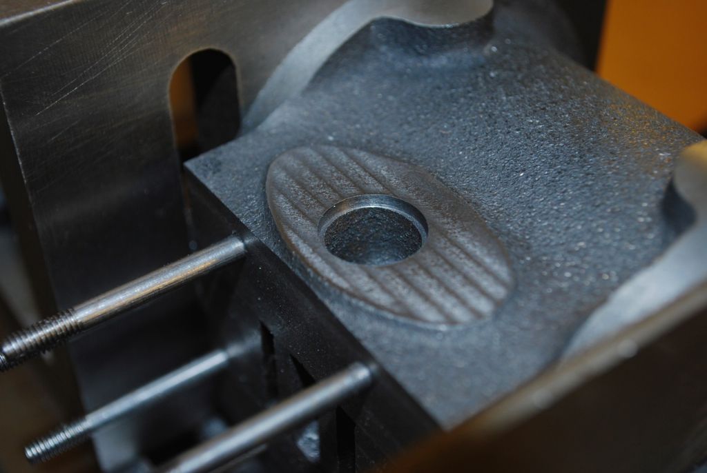

20/10/2015 14:20:42
Didn't get much time this morning, couple of quick photo's of what I did get done, along with setting up the Steam Exhaust Flange in the lathe ready to start working on it tomorrow...
I think its lucky for me that I left this one until last as it look likes it may the most difficult to get right. The cast hole is way off centre in the tiny raised boss on the Cylinder and I would be struggling to even attempt this and the flange with a file - as it is I'll no doubt find it difficult on the Mill as the boss almost becomes flush with the circular bore of the casting on one side..
The flange will likely sit in this approx position to line up with the exhaust hole in the casting.. The Boss on the flange as cast is slightly undersize and there is likely to be very little material left once it is drilled for tapping. Also I don't know if it can be seen very well in the photo but the boss doesn't seem to be quite straight coming off the flange base and with so little diameter material to skim....just have to see how it goes I guess.
The cast hole is not very round, which is fair enough, but I thought I had better tidy up the mouth of the hole so at least to have something to centre on when fitting the flange. The hole is not vertical through the casting but after a short way in slopes up to the steam ports and is quite a good clean cast I think. The drawing says 7/16" for the hole but it is already a good bit larger as cast. I've used a 14mm Slot Mill to tidy the hole just to a 2mm depth which I can also use to centre... 452. the steam exhaust 6..jpg
After tidying the mouth of the hole.
The potential for me to get this one wrong in some way is quite high I think..! But all very interesting to do.

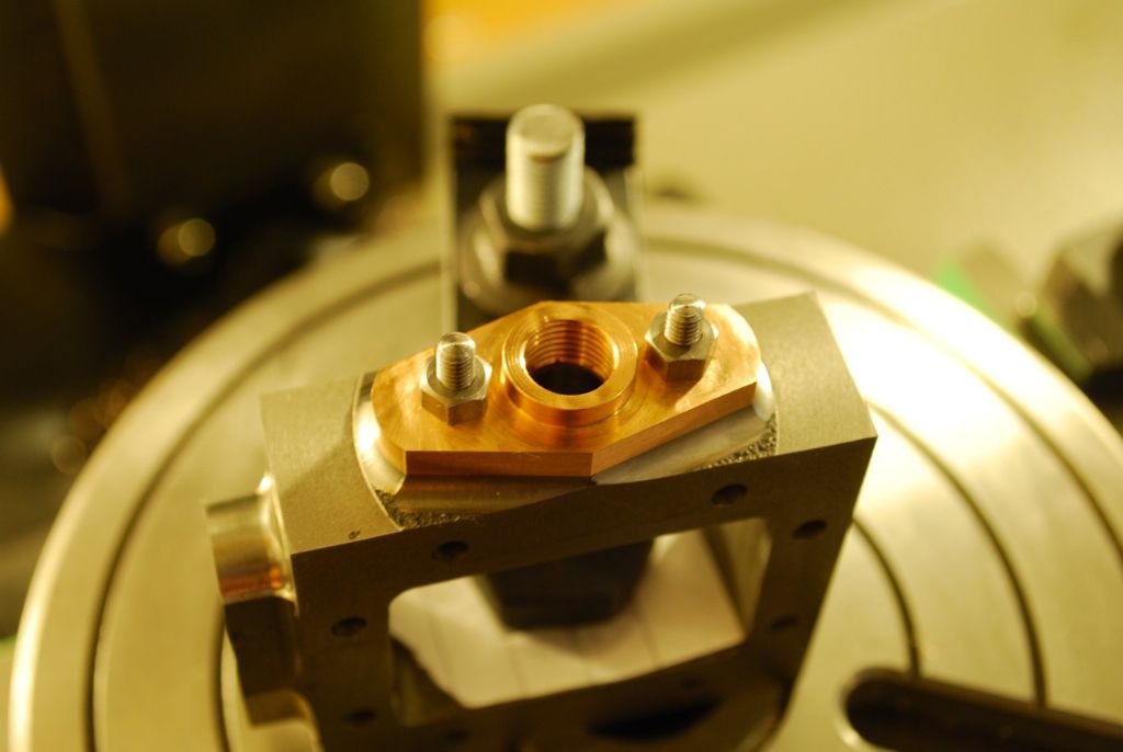

18/10/2015 12:33:06
A couple of photo's of the finished Steam Inlet Flange. I'm quite pleased as it's better I think than my first effort, I need to have gone slightly lower with the cutter and cleaned up the steam chest surface a bit more with it but I'm getting a better idea of how to go about it...
Sorry too many photos of the same thing again...
Setting up to mill the Steam Inlet Flange.
Just finishing the final cut - but i've missed some of the Steam Chest surface, should be able to improve on that again next time now I realise what I should have done.... The Radius Milling cutter comes down to pretty small diameter at the end, almost a point in fact - which I've not been allowing for..
The finished Steam Inlet Flange 1.
The finished Steam Inlet Flange 2.
Almost getting there, hope to improve again in doing the Steam Exhaust Flange next..
