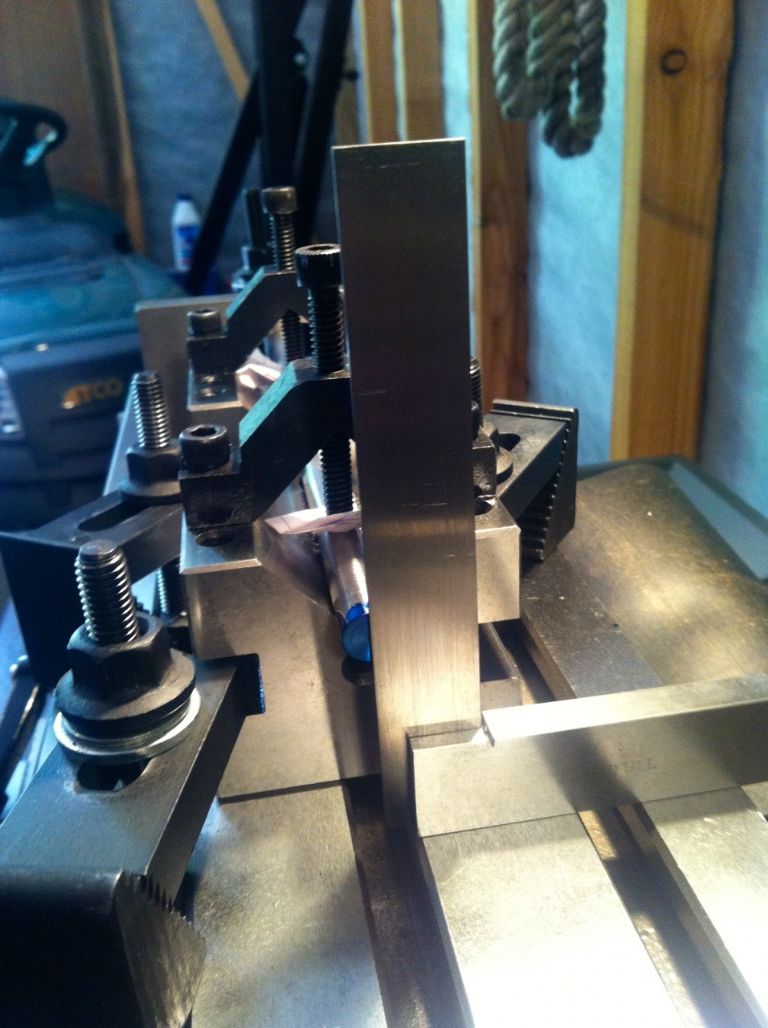

Thanks John
I did break one a few weeks backs now and threw it out! Hadn't thought about doing any future grinding then but will keep them in future. Yes I can see its going to be a bit fiddly adjusting the cuts but I imagine something that gets easier the more you times you do it - hope so anyway!
Just had another go at grinding again trying to get close to Jason's drawings. Its been much harder trying to get a couple of decent photo's than it was to do the grinding - and i've failed miserably, the iPhone just not focussing down that close..
Anyways here is a couple of the photos that I'm hoping will show if its useable or not. I did two but they are pretty much exactly the same.
Here is one of them..
2nd attempt at grinding the tool for the between ctrs boring bar 1.
2nd attempt at grinding the tool for the between ctrs boring bar 2.
2nd attempt at grinding the tool for the between ctrs boring bar 3.
Regards
Allan.

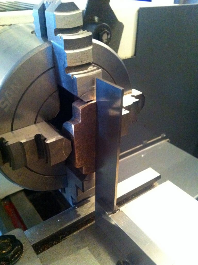

I was hoping someone may take a quick look at these (rather poor again I'm afraid) photo's please - apologies my iPhone having trouble focussing in on the small size..
Am I very far off from this being suitable for the between ctrs boring of my gunmetal bearings? I would guess this taken less than 60 secs to do so not expecting it to be correct. If anyone can give me any pointers I would be very grateful. Tool steel diameter is 1/8".
Many thanks.
First attempt at tool grinding for the between Centres Boring Bar 1.
First attempt at tool grinding for the between Centres Boring Bar 2.
First attempt at tool grinding for the between Centres Boring Bar 3.
Regards.
Allan.

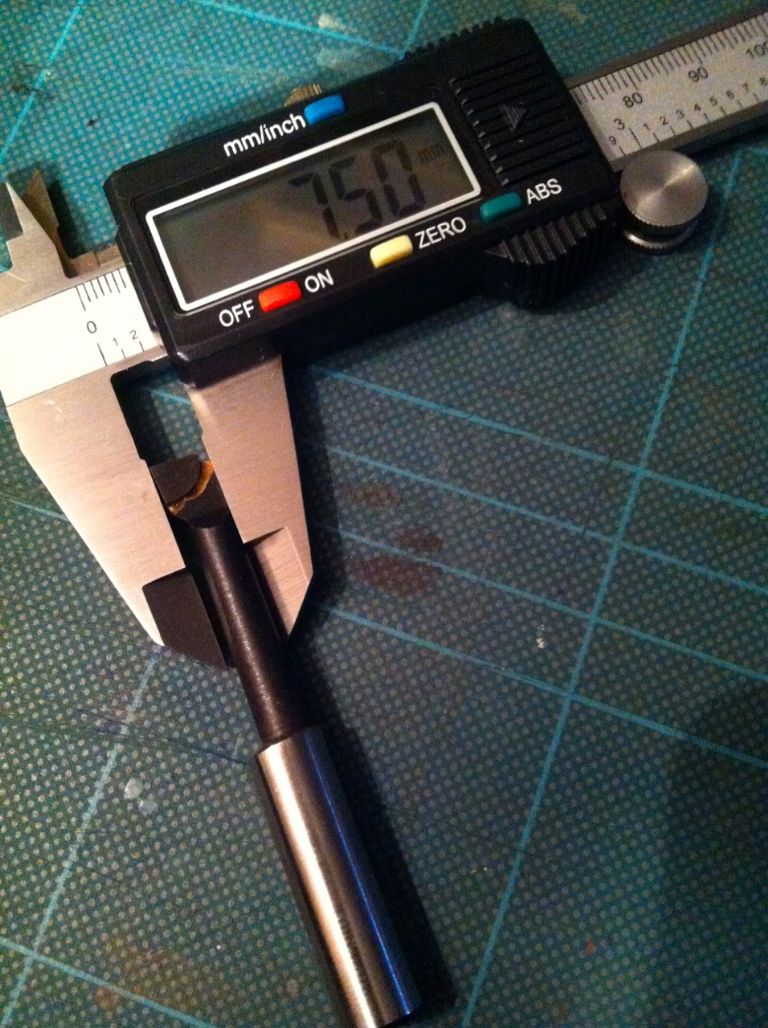

Thought I would quickly put up a photo of my new Grinder - its tiny! I was going to use it in my workmate but think I'll likely use it in the vice, seems to run nice and smooth - the little bolts I used for fixing clamp down the rubber cups that were fitted under the base (included) so no vibration at all . Don't know how much I will use it yet and it would only be for small things I'm sure. Great for £20 incl del. - and the tool steel's arrived and fits my boring bar perfectly..
Wont be fitting the 'eye' guards as I would never use without full face safety wear...
1/8" Tool Steel fits perfectly in the boring bar 3.2mm hole..

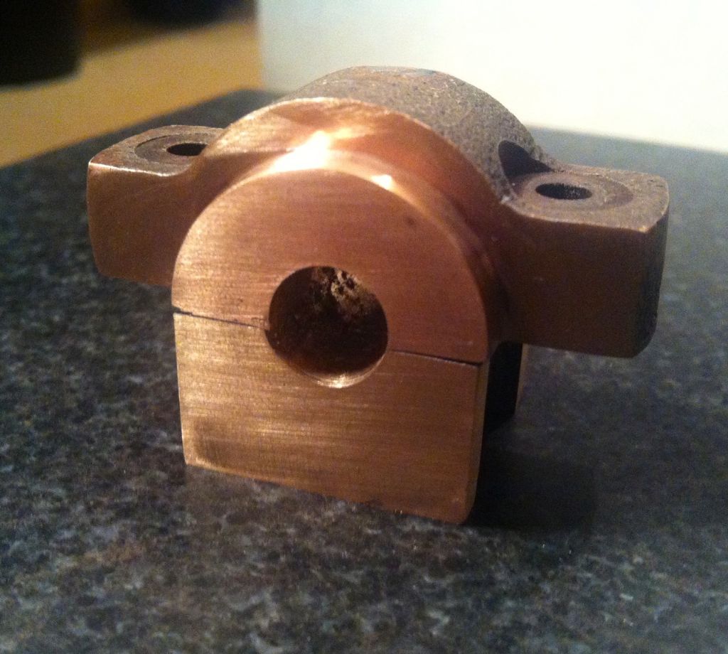

28/05/2014 19:40:29
I'm wondering if the misalignment will bore out in situ on the lathe cross slide. The finished bore needs to be 12.7mm. Since the bearing joint failed and I re-soldered I've had a boring bar through and the hole I guess would be about 8mm at the moment. The photos show the re-soldering has misaligned the bearing halfs'. I wondered what others would do - from the perspective of this being only an all time project no. 2 that is. I can't expect anything like 'brilliant' yet of course and should maybe see if I can get away with it and put it down to experience? Or should I redo?
This after the joint had failed and re-soldered - and me thinking I could get in with a small boring bar.
96. bearing disaster 1..jpgMy smallest boring bar that would be long enough..
103. small boring bar.jpgThis would be the 'front face' in the housing. It looked much worse yesterday with all the re-soldering marks etc.
97.bearing disaster 2..jpgThe front face again. 2.
98. bearing disaster 3..jpgThis is the 'rear face' or internal face when in the housing - you can plainly see after re-soldering the misalignment.
99. bearing disaster 4.jpgIn the housing - again you can see the misalignment on the housing 'block'..
100. bearing disaster 5.jpgIn the housing - again you can see the misalignment on the housing 'block' 2..
101. bearing disaster 6.jpgIn the housing - again you can see the misalignment on the housing 'block' 3.
102. bearing disaster 7.jpgI would be grateful for any opinions - from an all time no.2 project that is. I imagine many on here wouldn't dream of continuing with it, but remembering back to when you were starting out....?
I've certainly learned from it, which is always a good thing... Strangely I have developed quite a fond memory of some of Victoria's mistakes that still sit on the engine.. I have to improve on that though this time around..
Regards
Allan.

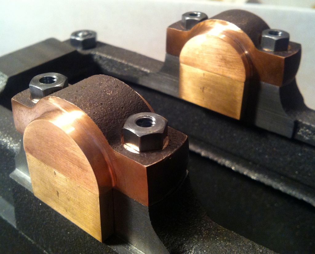

28/05/2014 19:30:17
Hi Ian
Yes, as Jason says - talking about studs just for clamping. I have a feeling whoever designed my clamping studs has never had to use them, I nearly always have to use more than one 'clamp' per stud to be able to tighten.. A continuous thread would seem to make much more sense for that job..
Hi Jason
Thanks, I've used Tracy a lot so its good to have that link, I think they will be useful..
Ready for some more soldering now after doing the fixing holes on the other bearing cap. Been wondering a bit how the initial drilling of the bearing 'permanent pairs' through on the join is going to go... and hoping that at least having the cobalt bits now will maybe increase the odds of success... The gunmetal was 'grabbing' at the bit when simply drilling the bearing caps - imagine it may be worse on the join. Yet another first at that..
No washers on the bearing cap drawings by the way - but something to remember to check before spot facing in the future!
A few more photo's finishing the fixing holes..
The second bearing cap with fixing holes and spot faced..
Test fitting both bearing caps - just lined up by hand, not fixed yet 1.
Test fitting both bearing caps - just lined up by hand, not fixed yet 2.
Test fitting both bearing caps - just lined up by hand, not fixed yet 3.
The photo shows it doesn't line up perfectly on the housing, bit too long on the one end - but it's not too bad..
Regards
Allan.

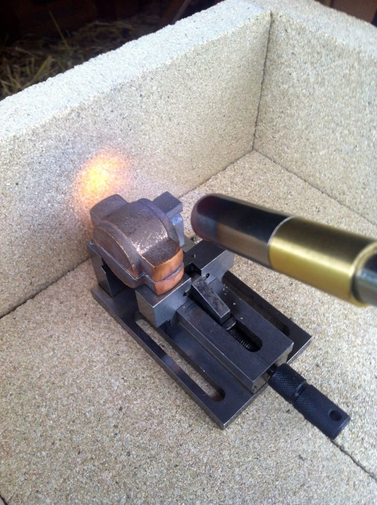

28/05/2014 19:24:10
I like the idea of trying to make a little progress most days, no matter how small even when time is difficult - it keeps things moving forward, not always possible but it worked well with Victoria..
So this morning I just separated the bearing half's ready for the next step..
Heating to separate the top bearing half's. It seemed to take a lot more heat to separate them than it di
The top bearing half's after separating 1.
The top bearing half's after separating 2. At this point I wondered if I had over done the heat and ruined them - but after a little rubbing on some wet and dry paper they came up very easily. Think I had to put in a bit more effort than 'normal' for this though in order to get rid of my bad tool marks which were preventing cleaning up properly - hopefully as I'll need to clean them up again shortly after soldering for drilling and boring, it will be easier to do next time around...
The top bearing half's after some cleaning 1.
The top bearing half's after some cleaning 2.
Decided to drill the fixing holes after separating so I could spot face on the Mill in the same way as earlier - next job to do..

28/05/2014 19:18:05
Hi Jason
Yes, that makes sense and will do - I was quite surprised it wasn't more 'messy' than it was when doing it, I'd imagined it running lots more..
A little more progress in the Lathe - it will be worth in the future trying some of the CCGT carbide inserts for Gunmetal I think..
The bearing 'tops' in the lathe ready for the initial facing.
Facing in order to be able to mark the centre..
After marking the centre, setting the bearing 'tops' to run true..
The bearing 'tops' so far 1.
The bearings tops so far 2.
Regards
Allan.
28/05/2014 19:14:42
Great fun before breakfast this morning - soldering the top bearing half's together.
Thought I would quickly put up the sequence of soldering steps in case anyone like me who's not tried it before may be interested..
Hopefully if I've messed up someone will explain..
My little soldering hearth...
60. setting up to solder the top bearing halfs 1.jpgThe solder paint applied when cold - i don't know if this was maybe too much. Applied with a matchstick I'm afraid..
61. the solder paint applied when cold.jpgInitial heating.
62. heating the top bearing halfs.jpgAfter heating and wiping off the excess solder.
63. after heating and wiping off the excess solder.jpgSolder paint reapplied to one surface after cooling.
64. after cooling and applying more solder paint to one surface.jpgThe two half's placed together.
65. the two bearing halfs placed together while still cool.jpgReheating.
66. reheating.jpgI think I heated too much as they slid apart slightly.
67. heating too much - they slide apart.jpgBack in line and cooling.
68. the top bearing halfs reset and allowing to cool before machining.jpgCooling before machining..
69. cooling 2..jpgOn to the lathe now - after breakfast..
Hope some found it interesting.
Regards.
Allan.

28/05/2014 19:07:44
Didn't get to make as much progress as I thought I would this morning but am now at the point of being ready to solder. Just managed to clean up the 'top bearing half' castings and faced the surfaces ready for soldering. Had some strange marks though left on the surfaces afterwards that I haven't seen before...
The top bearing half castings after cleaning up with the file. They took quite a bit of filing.
Setting up to face the bottom surfaces.
I only took a light skim off ready for soldering, 3 thou at 380 rpm, maybe I should have taken off more, or I'm using the wrong speed (they are Gunmetal). I don't know if these marks were already there under the surface or the tool was digging in. The carbide insert has I suppose done a lot of work, may need changing, but it looks ok under a 'glass', like new in fact - there was absolutely no sign from the lathe when facing that there was anything untoward happening - bit of a mystery to me. As the surfaces are completely flat and I will be boring through most of it shortly rather than take any more material away I thought it would still be ok for temporary soldering and plan to go ahead like this - unless anyone is kind enough (if thought necessary) to advise me otherwise that is..
Regards
Alan.
28/05/2014 18:49:53
Both the bottom bearing half's in the housings now. Next the top half's which I need to temporally solder together to turn on the lathe.
Test fitting the bottom bearing half's. Think I did a slightly better job on the second one - which is as it should be second time around, but both seem to fit ok and feel solid with no movement.. The second one done is on the right in the photo..
My new 'very basic' soldering kit. Not much idea how to use it yet....
I wanted to ask if it's just a matter of applying the solder paint on both surfaces of the 2 'top bearing half's', clamping together and heating? Do I need to heat from both sides or can I just lay them on the vermiculite fire brick without moving, (have more than one of these bricks of course..)? I assume I just heat up afterwards to separate and wipe the surfaces off while hot, do I need a solvent for this?. Do I need to wait long after cooling before I can put it in the Lathe or do they have to be left to stand... How hot do I heat?
Sorry lots of questions there - but thanks to anyone for any pointers, even one or two would be a great help..
Regards
Allan.
ps. won't do it next to the straw of course..
28/05/2014 18:48:22
For the sake of completeness - forgot to include the setup used on the mill for the channel...
Regards
Allan.
