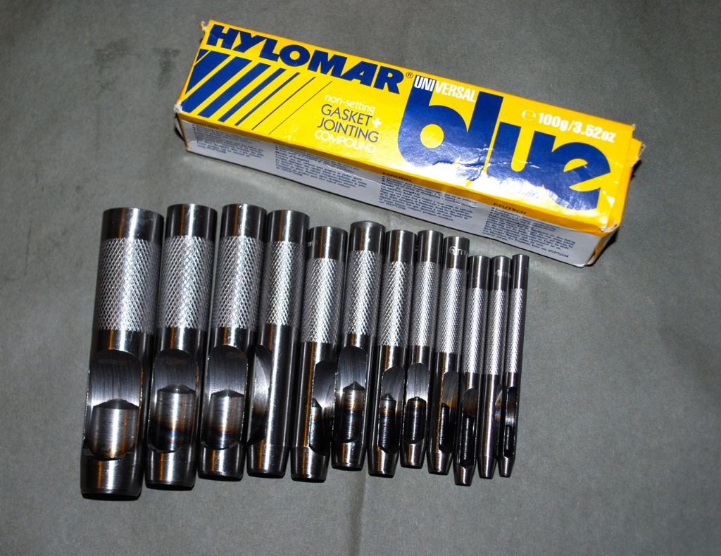

Getting a bit ahead of myself here, but these were cheap (£6 I think) - hole punches ready for some gasket making in due course..
Main thing for me is that I feel I'm definitely learning and going forward...smile

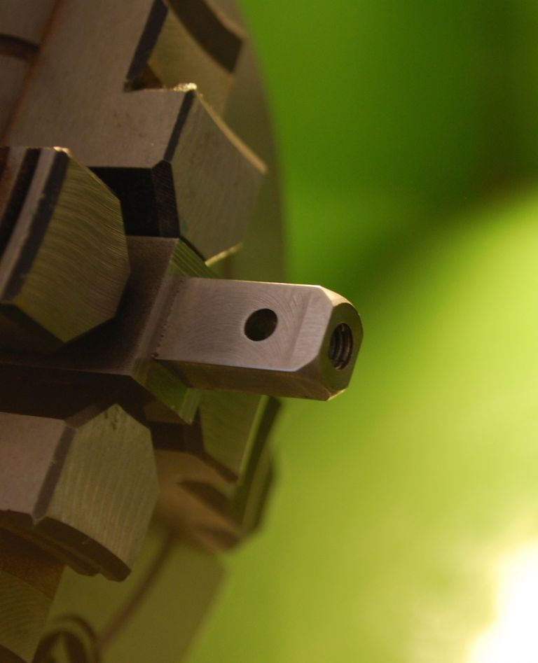

and then onto the lathe for drilling and Tapping - I made a silly mistake in drilling the cross hole in too far from the end, so a bit more facing off afterwards was needed than could have been..
Tapping the 2BA hole for the Valve Rod..
and test fitting the Valve Rod..
I didn't understand the 1/8" radius reference on the drawing for the ends, or rather how to do that accurately on the lathe - so I did at 20 degrees with the top slide - but looks ok I think.

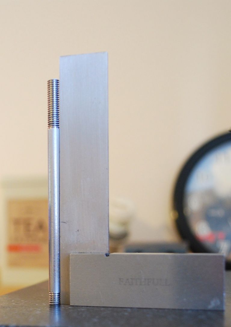

Just the Valve Rod done today..
Definitely a lot easier to do in two passes with the Die - I'm not sure its quite straight but very close, I'm guessing it would have been more accurate with a Tailstock Die Holder unless its just that I've not cut the 3'4" length threads quite as deep as the other maybe - it would have been easy to have tightened the die the same for both if I had thought, worth remembering next time to do that..

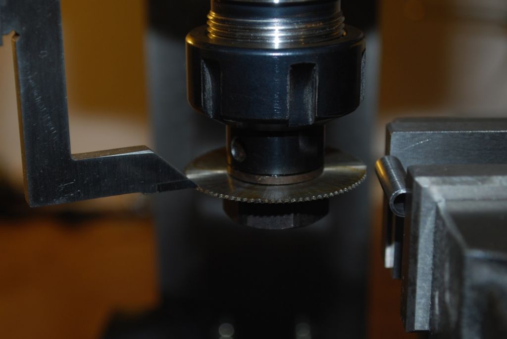

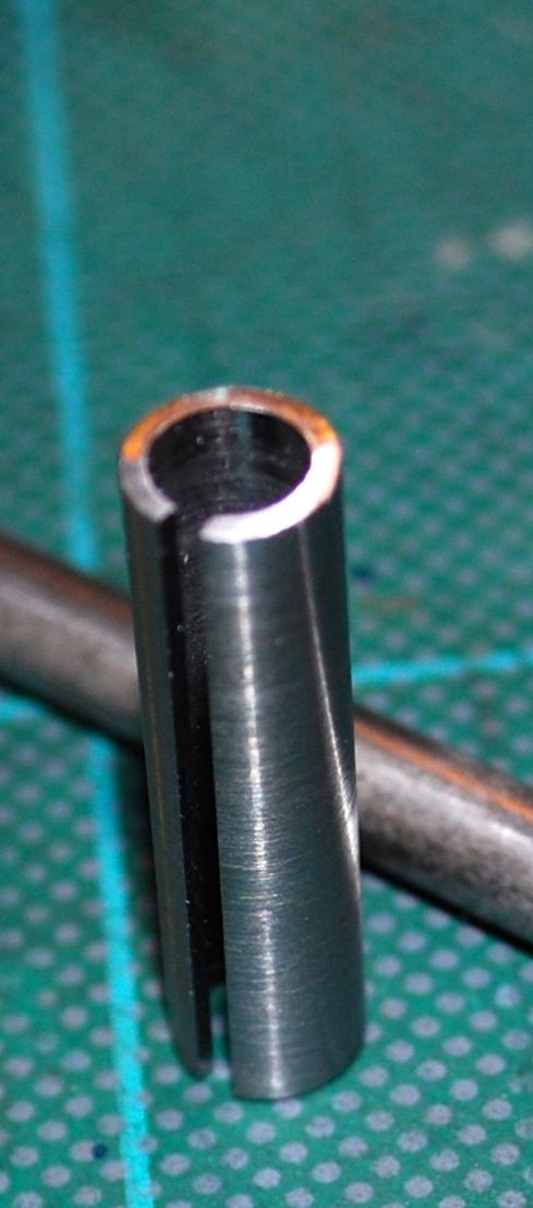

Making another 'split sleeve' this time for holding the Stainless Steel Valve Rod.
My collection of these is ever growing..
For anyone interested I think the numbers were..
Valve Rod diameter - 4.75mm
Sleeve drilled - 5mm
Slitting Saw thickness - 1.62mm
(so enough slit room to close tight on the Rod when clamped - and easy to get the sleeve on and off)
Not a very good photo but the sleeve should be able to hold tight enough without marking the Valve Rod - May reduce the diameter a couple of thou with a file in the lathe to make the threading easier - the rod is slightly oversize for the 2BA thread at the moment.. Unfortunately something I don't yet have is a Tailstock Die holder..
(I'll clean it out before using).
