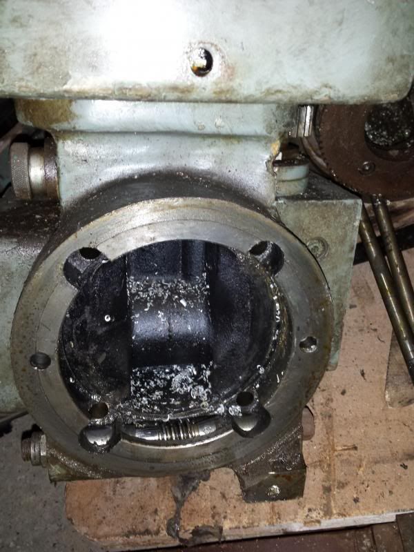

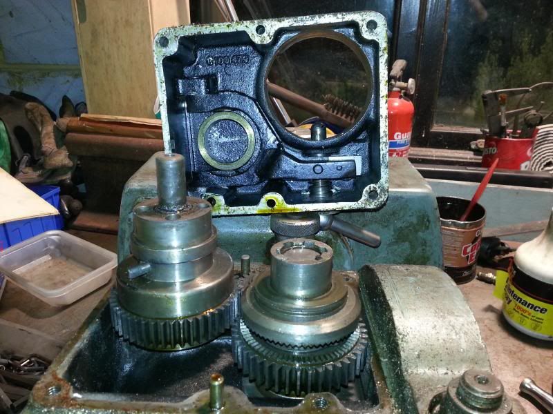

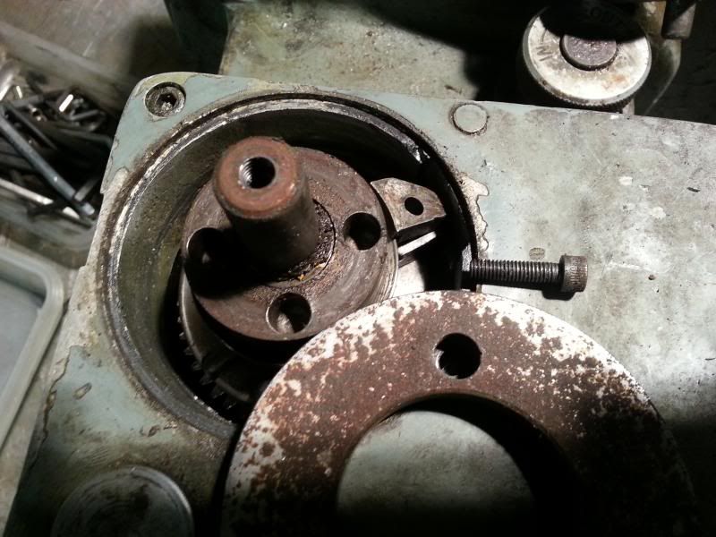

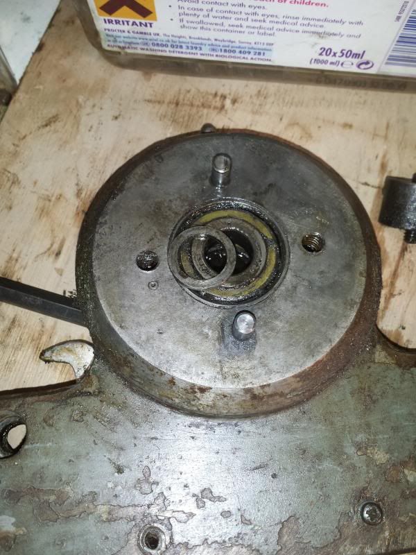

Anyway, for posterities sake, started to dissassemble the gearbox which as well as transferring drive from the pulleys to the quill, also handles the backgear.
First of removed the back gear lever, note spring that maintains the "detente" position on the lever,
The output shaft of the gearbox has a cog retained with a circlip. Circlip was removed and then a puller used on the gear revealing the woodruff key and rubber o-ring.
Flipped the 'box and attacked the top. The cover plate is held in by 4 screws but still wouldn't pop off. It turns out the backgear shaft has a bearing on the top end of the shaft which locates in the plate. To get the plate off you have to slide it off this bearing, but without anywhere to locate a puller its a bit of a job.
Eventually levered it off.
This is the insides of the gearbox, backgear shaft on the right and backgear selector hanging off the main shaft.
Backgear selector, wheel and clutch slid off the shaft
The shaft sits in a large bearing that sits in the bottom of the gearbox covered by a retaining plate on the underside and held in by the large circlip you can see in this picture.
In the above picture you can also see a smaller circlip on the shaft itself, this is why the shaft cannot be withdrawn from the bottom of the gearbox and has to be removed via the procedure described above, i.e. from the top.
With the main shaft out of the way I could then proceed to remove the backgear shaft. Some improvisation with another gear puller smile o
and the shaft complete with lower bearing comes out.
Next step, pressing out the main bearing and dropping the casing in the solvent tank, unfortunately I got a little bit distracted by purchasing and setting up this wink

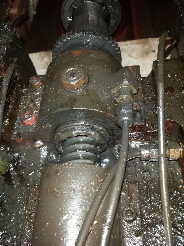

With the quill out the next part to remove was the feed gearbox.
Grease, grease and more grease laugh
View down the quill housing

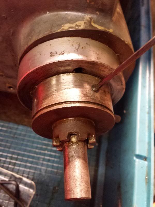

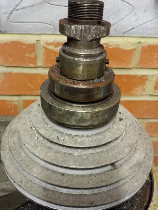

With the quill and gearbx outta the way I turned my attention back to the top part of the head. Remember the brake attachment on the top of the spindle that I couldn't get undone? Turns out it is screwed onto the spindle. With the quill removed I was able to lock the spindle and undo it.
and then pull the bearing off.
I was then able to pull off the top pulley and remove the toothed belt.
Next job was to try and get into the gearbox, easier said than done smile o

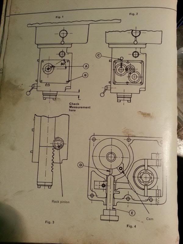

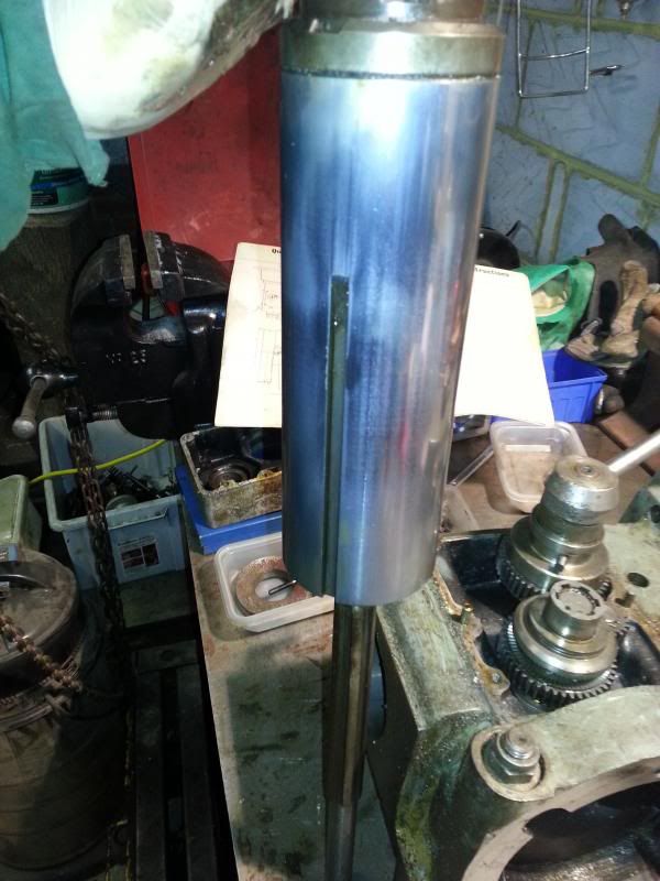

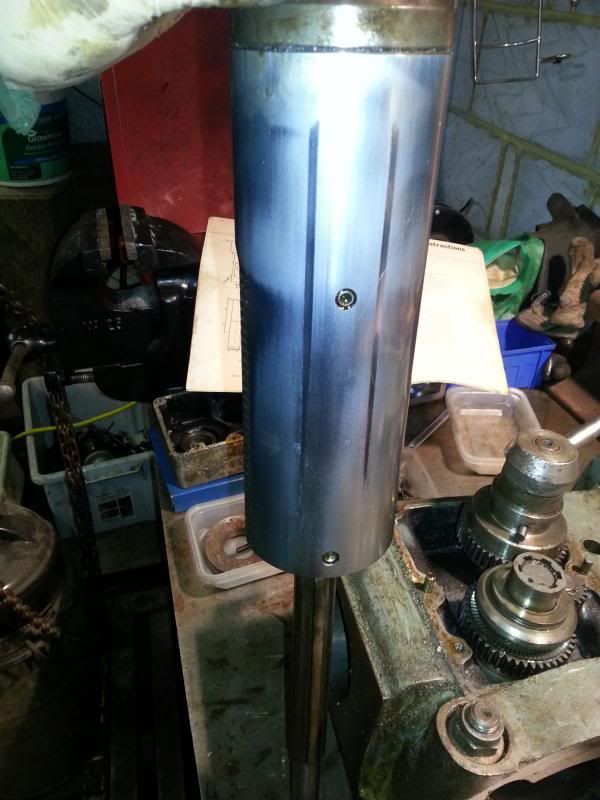

With the head off next job was to remove the quill. In answer to John's question last month the quill moves just under 5 1/2", which I guess makes it a 5" ?
Removing the quill is about the only thing the manual gives instructions on so I will include it here incase it is of use!
Setup for quill downfeed handle looks like this, mine is missing the micrometer dial
and removed shows the cam arrangement, (roughly 2 o'clock on the photo),
4 bolts undone and casing removed to show quill feed gears

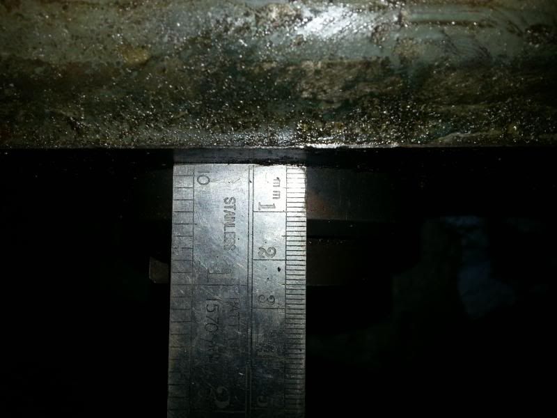

Quill protrusion measured,used when refitting quill,
then unwind the quill feed handle and the quill drops out of the head. Doesn't look in bad condition, couple of wear marks but no real grooves.
This is the locking pin for the quill

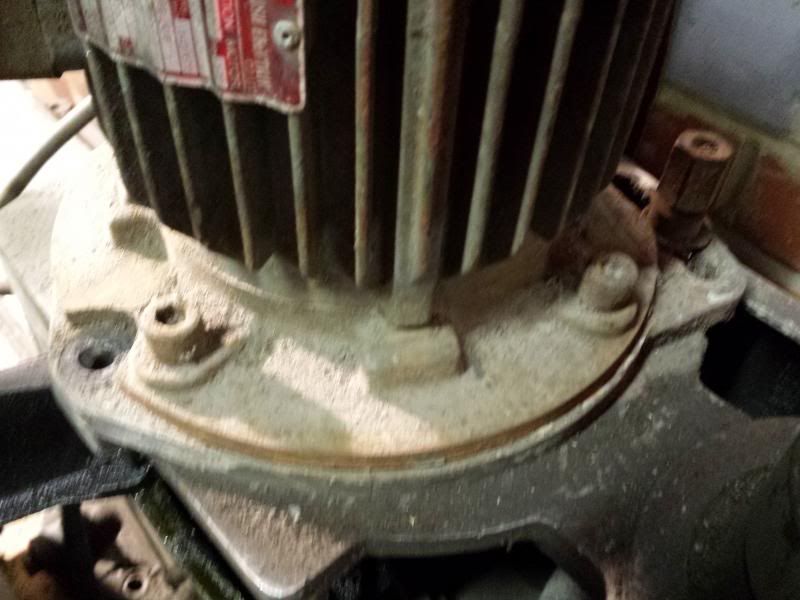

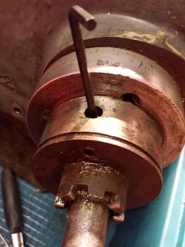

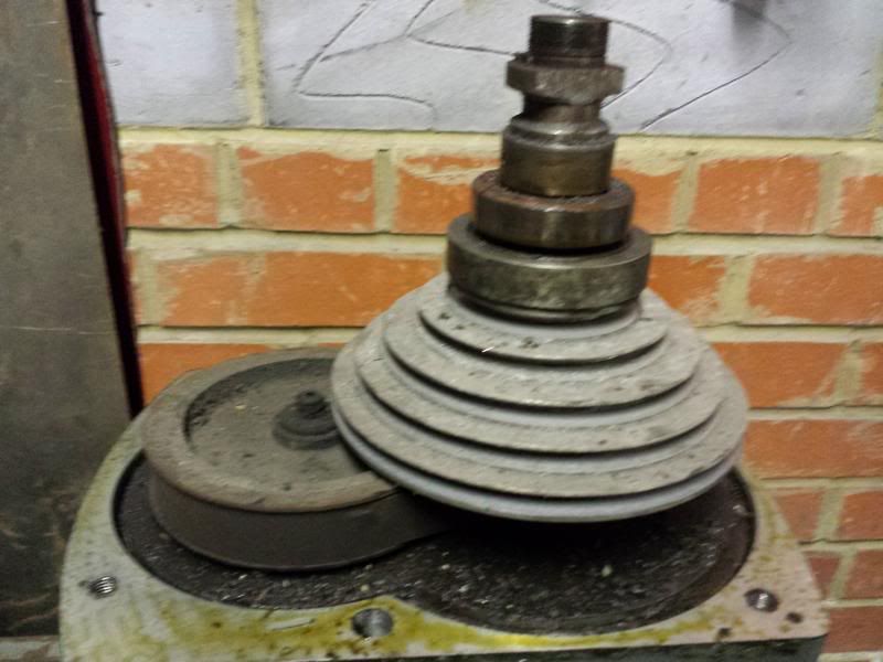

Got bored with cleaning so decided to strip down the head. This unit has a thumping great 2 speed electric motor sitting ontop of the 8 speed belt system. Not sure yet how many speeds that gives but it seemes a lot laugh
The motor is held in situ by 3 bolts and is on a moveable plate to allow for tensioning of the belts.
The head also has a lever operated braking system that sits on top of the main spindle.
Undo the locking washer and nut on top and the brake "drum" together with expanding shoes pops off the top of the spindle. The pulley cover can then be removered after undoing about 6 hex head bolts.
In the picture below the top part is where the brake mechanism sits then there is a bearing beneath.
Underneath this is the second pulley wheel which is connected to the main drive shaft via a toothed belt.

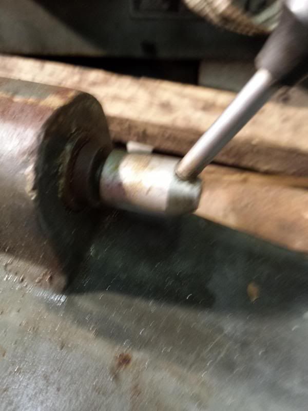

At this stage I tried to remove the brake attachment from the top of the spindle but couldn't see how it was attached. It does have a couple of grub screws as seen in this photo
but even with these backed of I couldn't budge it. It looked like it was threaded on but turning the top just wound the quill in and out so I left it in situ for the moment.
Having got the motor off I decided it would be easier to work on the head on the bench, so 4 large bolts on the front face of the head were removed and the the head will seperate from the arm.
In this pic you can see the screw/gear arrangement that allows you to cant the head from side to side (it will swivel 180 deg on these almost making it into a horizontal miller)

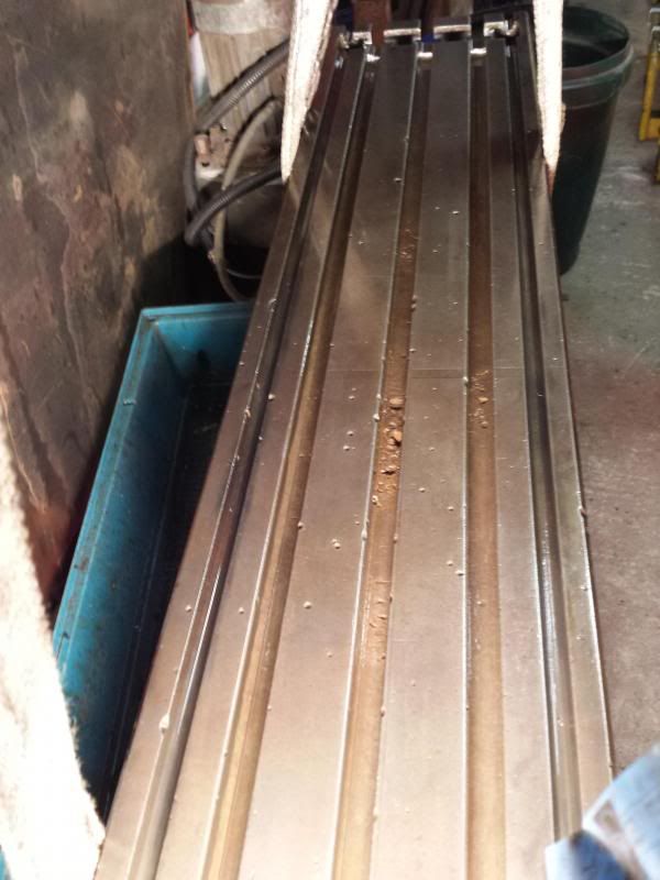

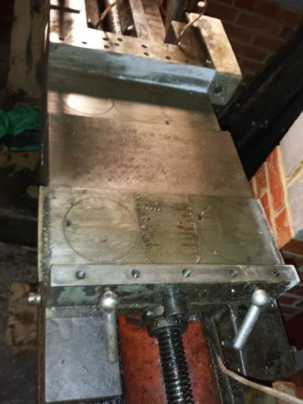

Not been able to do any updates for a while, broadband has been down. Took BT a week and 3 different engineers visiting to get it working again angry 2
Anyway got to work on the table. Tried various approaches ended up going over it with a brass wire brush after lots of attacks with degreaser. Not sure it will ever end up looking like one of those nice new polished chrome looking mills but at least its clean

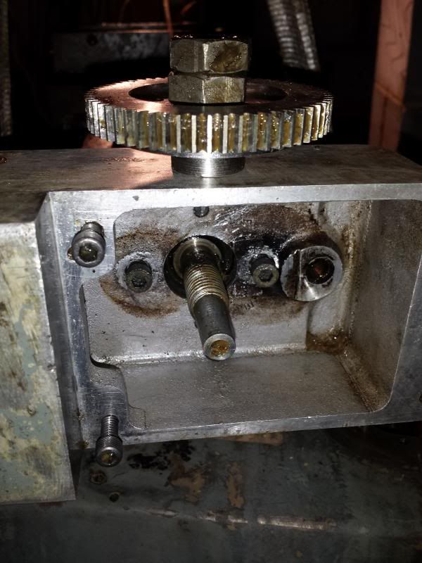

10/01/2014 00:05:50

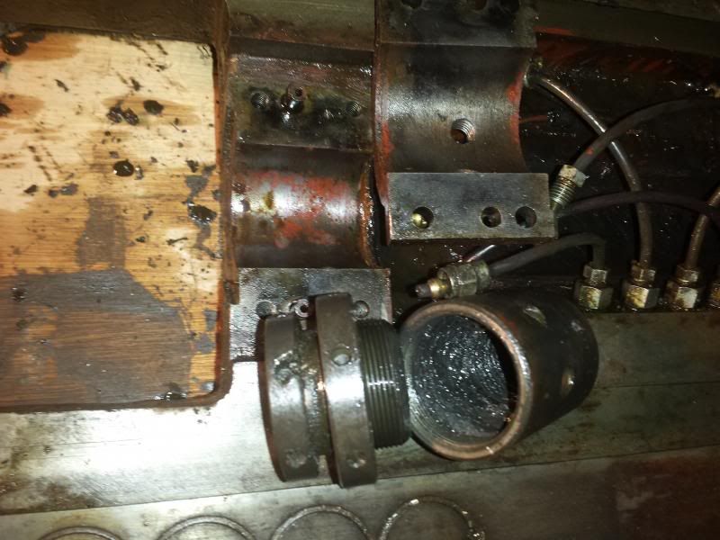

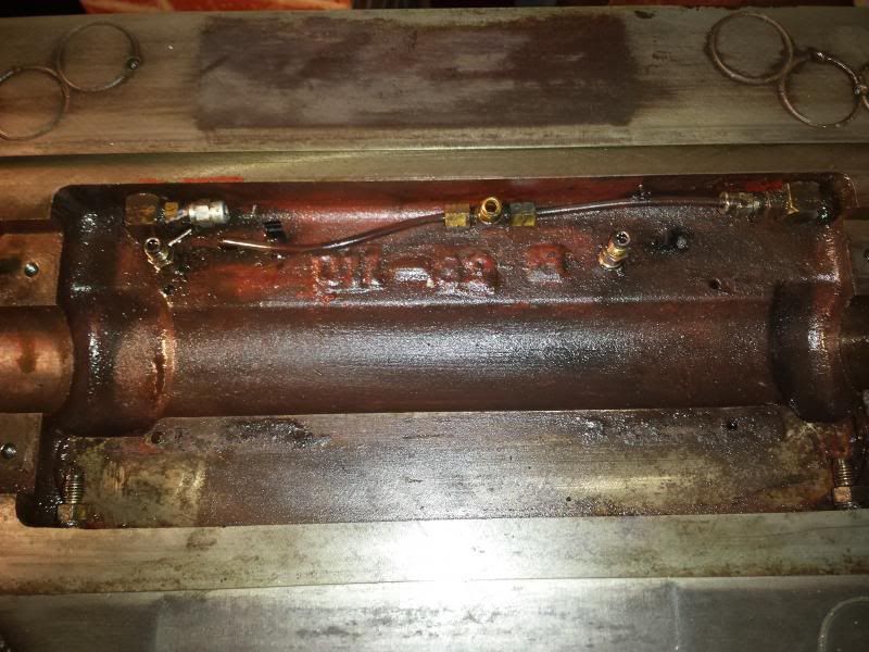

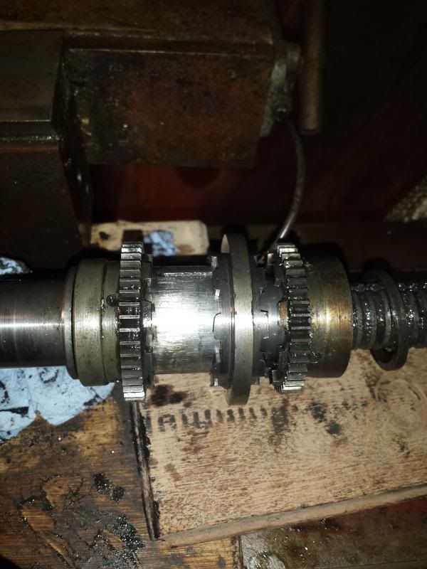

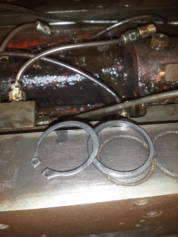

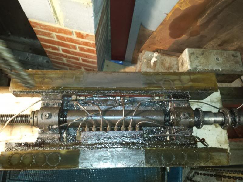

The leadscrew has two motors, a rapid return and a slow feed. Again the manuals only show hand screws for the table feed but I know the rapid return was an option on these mills – just don’t know which end is which laugh

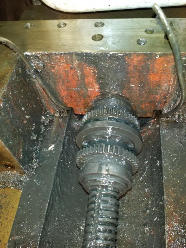

So removed the gearbox cover plate and waded through masses of greases to find a cog held on by a double nut.
Removing this allows you to remove two bolts that hold the gearbox to the table end bracket. This houses the bearing the end of the leadscrew runs in and is located on 2 dowels.
The table feed gearbox assembly is held in place on the leadscrew with a circlip and thrust washer.
Having loosened the gears at one side of the saddle and backed of the backlash adjustment collar on the other side I then gradually removed the oiler reservoir and tubing.

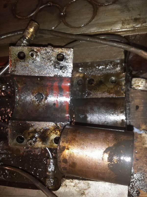

The leadscrew sits in 2 bushes held in place by bearing caps
With the caps, tubing, and shield removed the leadscrew will then lift off the table.

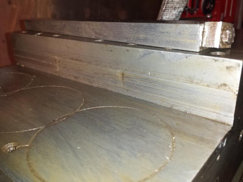

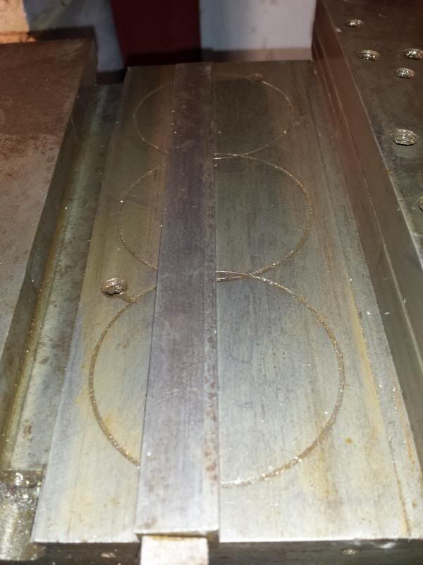

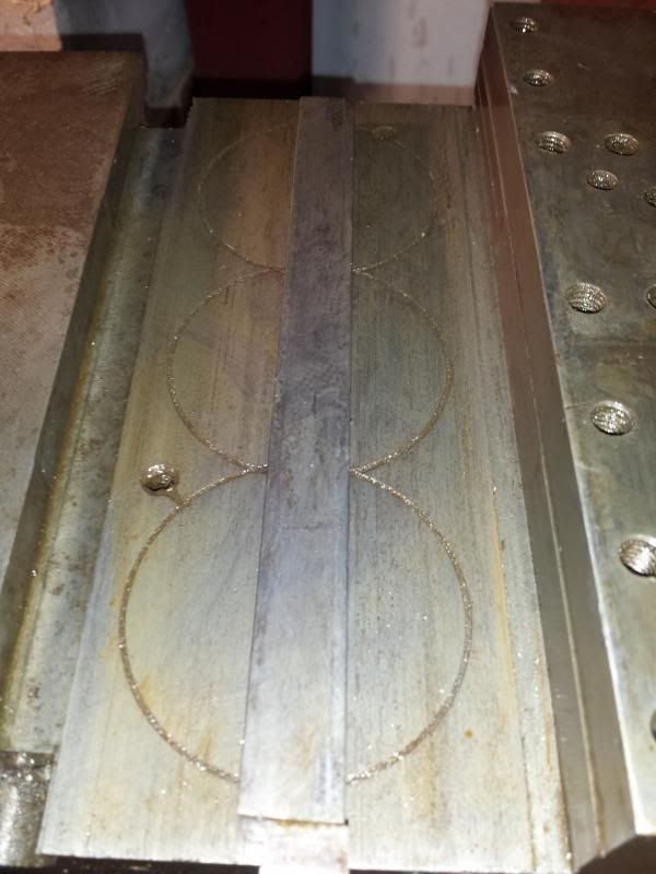

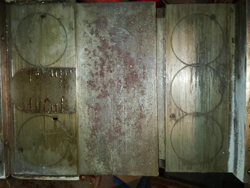

Having cleaned up the saddle some more I gave it a closer inspection. These are the ways that match up to the outside of the saddle. They seem to have matching grooves worn in them.
I wonder if at some point swarf has become lodged in-between these two surfaces and scored the surface. As mentioned above when discussing the knee, my challenge will be deciding whether it is worth trying to reface these surfaces, or whether to refit the saddle to the knee and once adjusted with the gib, ascertain if it causes any real tolerance issues.
The saddle to knee gib looks in reasonably good condition.

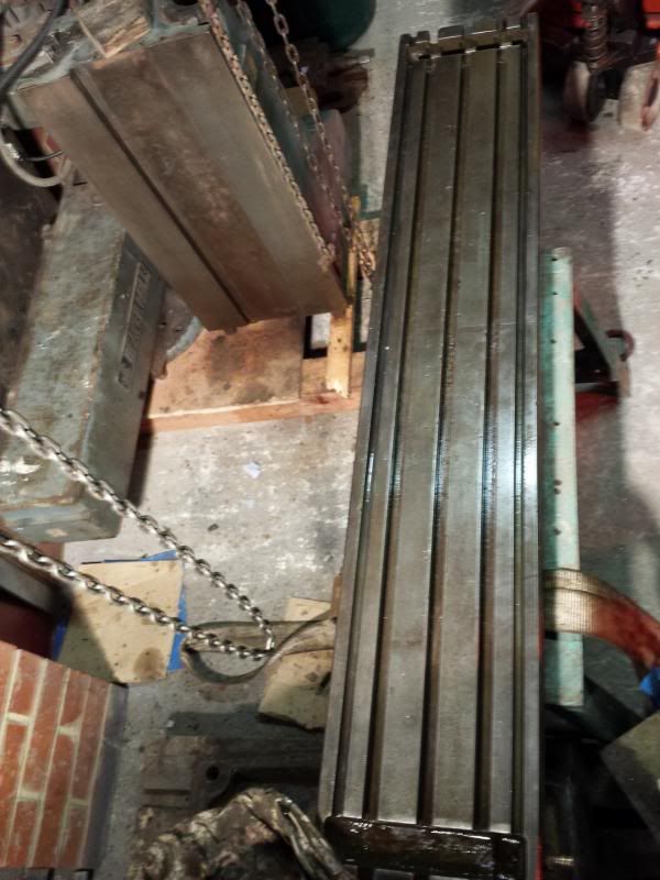

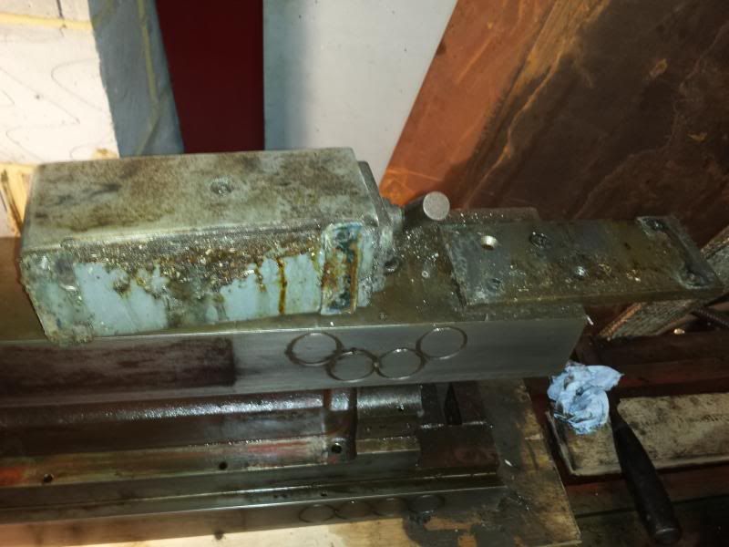

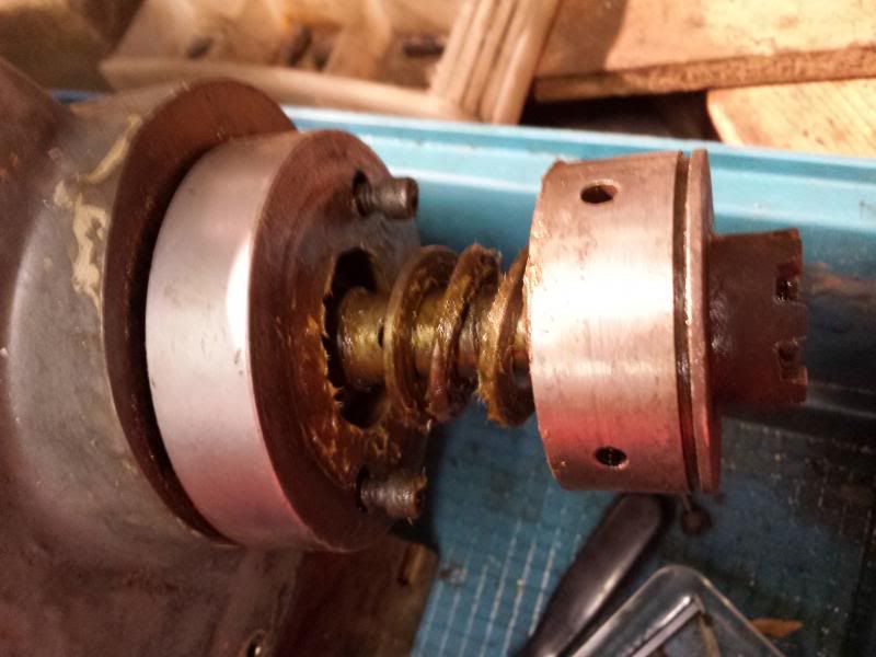

With the knee stripped and cleaned it was time to move on to the table. A bit more playing with block and tackles and we have the table mounted ready for work .
The table is upside down obviously (and weighs a ton!) but this allows me to check out the ways/mating surfaces on the saddle to knee area.
The last pic shows the two locking pins that lock out the saddle to knee.

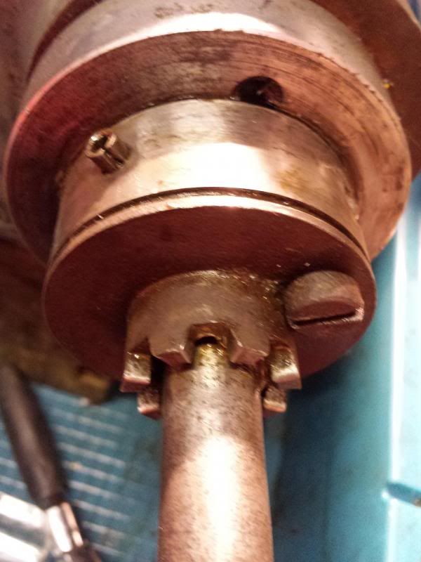

Next step I thought was to remove the leadscrew but I couldn’t see any way of doing this with the saddle in place, so the saddle came off. I guess if it was all assembled this would be the same procedure for removing the table.

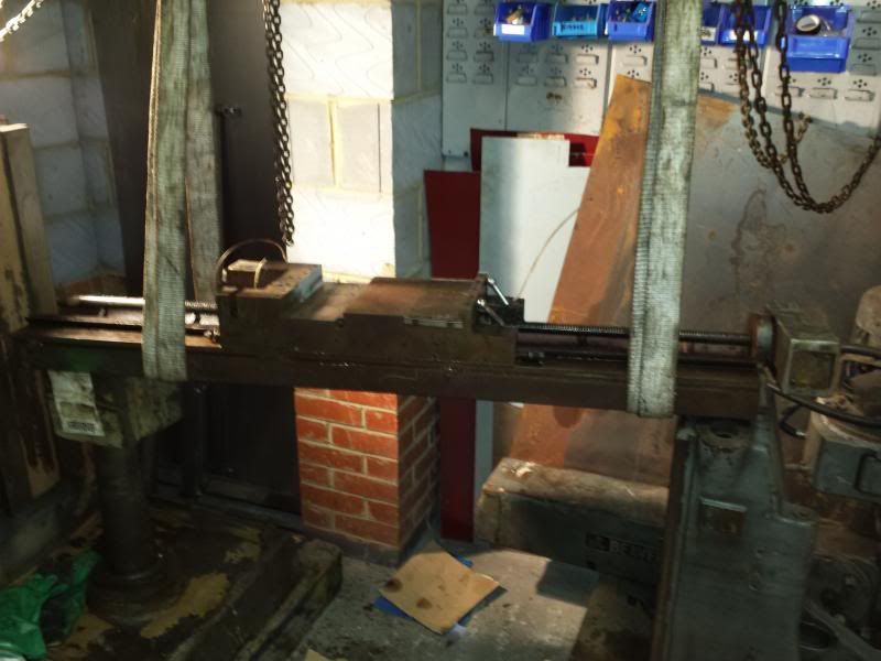

The saddle is held in place with two tapered gibs adjusted by a double nut arrangement (forgot to take pictures). With the gibs removed the saddle can be lifted off the table ways to reveal a spaghetti junction of oil pipes where someone had fitted an auto oiler!smile o
One side of the saddle is what the manual refers to as a “table feed gearbox assembly”. To be honest I haven’t got my head around how this works as the table and saddle where already removed when I picked up the mill.crook
The other side of the table is the backlash adjustment screw together with a retaining collar.
So that’s the saddle off, next job, remove the leadscrew.

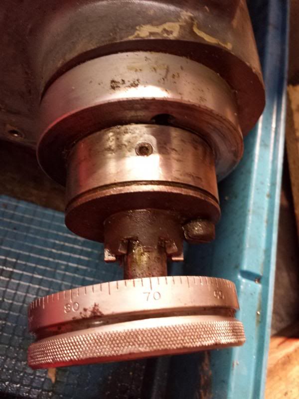

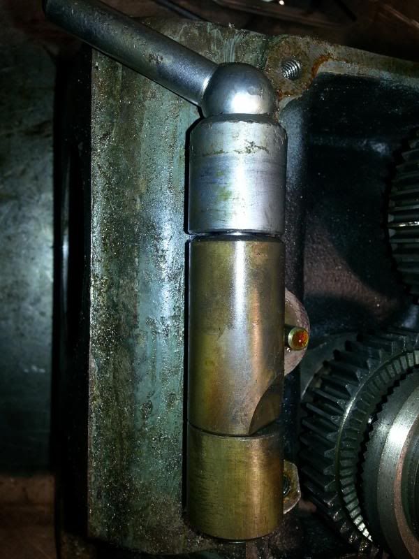

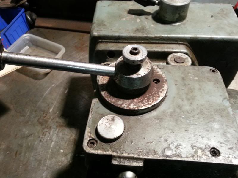

Continued with the cleaning of the knee. First job was to remove the handle and mic ring etc from the knee feed screw. After the huge effort it took to get the saddle feed handle and leadscrew out I have to say i wasn't looking forward to it!
In the end it took about 5 mins smiley. Whereas the other mic ring was rusted solid this one was nicely greased up. Took out the mic ring locking screw and the ring just popped off.
The collet the ring sits on had the same set up as the saddle, one obvious grub screw, a tapered pin and one less obvious grub screw under the ball bearing on the mic ring lock.
After removing these the collet ring itself came off really easily and then the Hoffman bearing and the 2 machine screws holding the spacer ring onto the knee could be taken off.
I had already unscrewed the knee pillar from the riser screw so now the complete leadscrew/gears/riser came out as one unit after removing a couple of machine screws that held it to the knee.
The motor for the knee is a later addition. The bevel gear on the end of the leadscrew is held on with a tapered pin, once this is removed the leadscrew pulls out of the carrier.

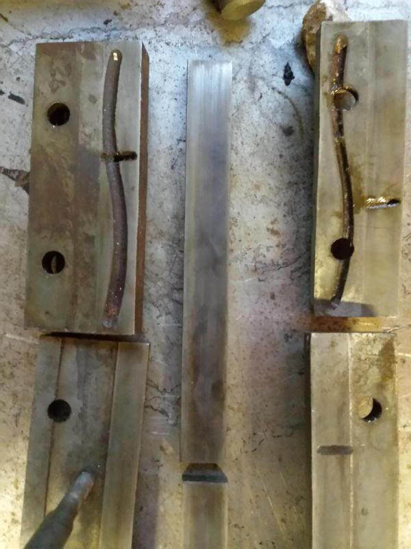

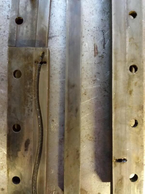

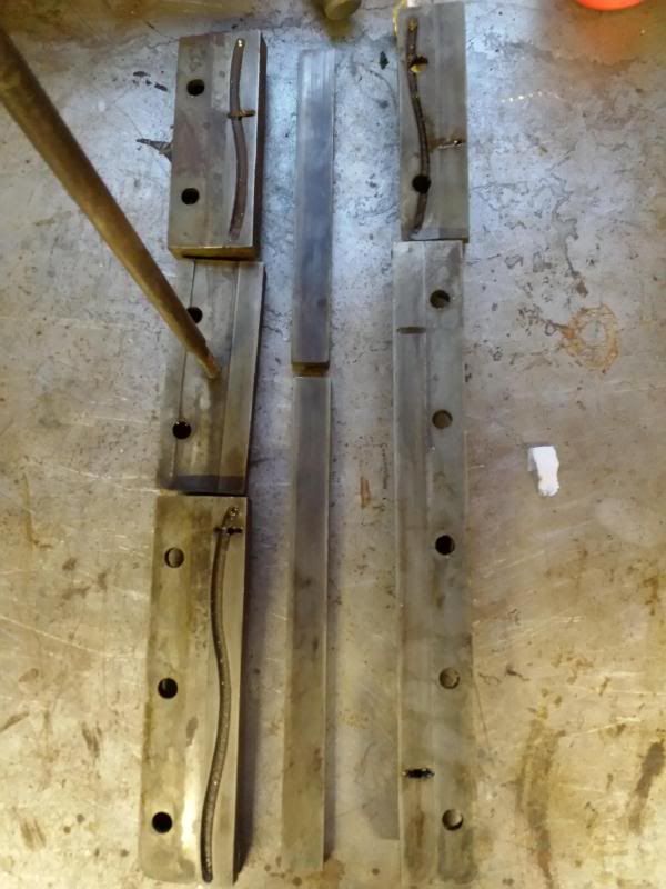

Next job was to remove the knee retaining plates and gibs.
Started by removing the handle from the knee lock.
The shaft this operates on is attached to one of the retaining plates as you will see in a minute.

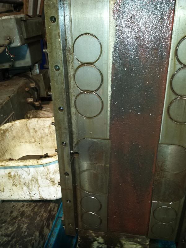

Said retaining plates were removed along with the gibs. These are straight gibs on the knee adjusted by a series of grub screws. Some pics of the plates and gibs.
I don't know if the grease points or channels were a later addition but it seems odd that 4 plates have "s" shaped channels and 1 doesnt, and on 3 of the plates the grease point is drilled into the channel and on 1 it isnt!
Plates and gibs look kinda OK, but not got any real experience to go on here about how to check/measure.
What was noticeable was the adjustment on the gibs seemed odd. The top grub screw (in the picture) was snapped off and the middle and bottom ones both had been wound in about 2-3mm whereas the ones in between were flush.
This implies to me the gibs on the knee hadn't been properly adjusted, but I'm no expert!.

The top surface of the knee looks to be in pretty good condition as well.
[​IMG]
Of more concern is the outside edge of the keyway which has some obvious wear towards the front.
At a guess it looks like the gib has been too tight and has worn a grove at this end.
[​IMG]
[​IMG]
The opposite side is fine but there is a definite groove worn here. Not sure how much impact this will have on the accuracy of the mill. Have run a DTI across it and it is about 5 thou deep, peaking at 10 thou where the line is in the middle of the groove.
So, the big question is, what sort of tolerances/wear should I deem acceptable on a mill like this. When built it will be used for mainly engine work, skimming heads, fly cutting etc.
I didn’t get a chance to see it up and running when I bought it so don’t really have a good idea of how tight it was. With the knee in place it is way too heavy to feel any movement in the knee and I haven’t reassembled the saddle to check this.
Have seen threads on scraping etc but was hoping to avoid this if possible.
So, what’s the collective wisdom here, what should I accept on the mating faces and how should I go about improving them?
Cheers,
