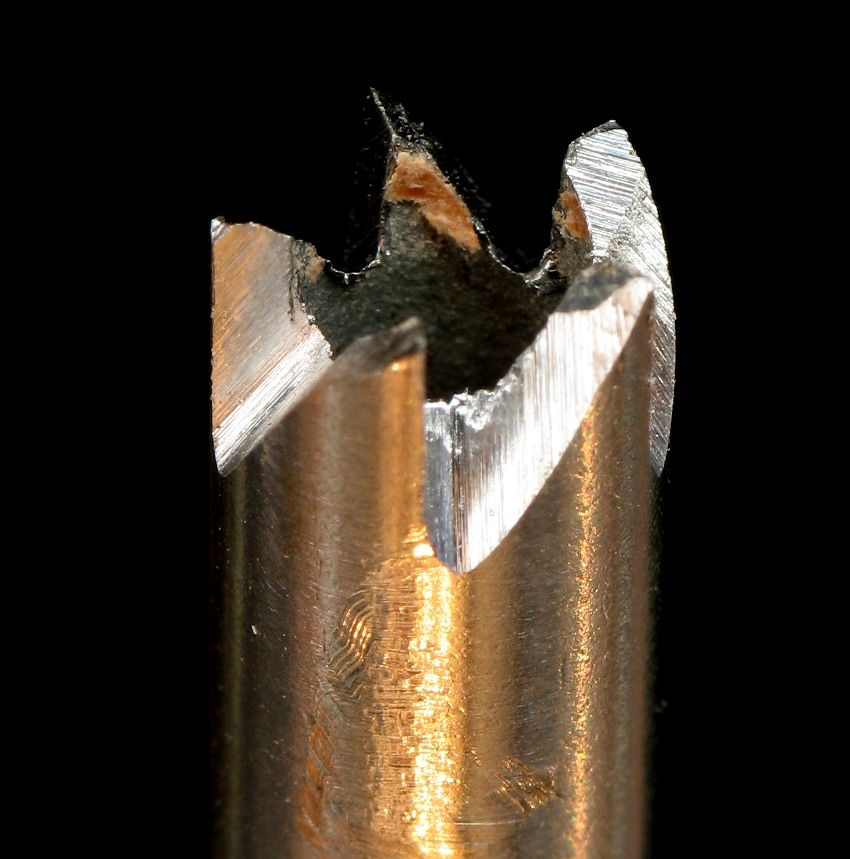

01/04/2016 17:14:02
Fuel line turns out to be really well annealed so you can bend it;
I have made a prototype hole saw; a friend gave me some scrap engine fuel line, which turns out
to be well annealed (so you can bend it) steel. Easy to file.
The OD is 5.5mm, I don't know the ID.
I filed 5 teeth around the circumference, with each tooth face on a radius.
On trial, the problem (shared with the commercial versions?) is that you have a saw with no means of removing the sawdust, so you have to keep withdrawing the bit to brush dust off the bit, and to (try to) blow out the hole.
So I returned to my teeth filing, and with the tube raised high in the vice, used a 45 degree slope to make a VERY large gullet on each tooth for the dust to go in. The dust still has no means of actual escape, but the teeth hold more now. This seems to work OK.
BugBear
PS Macro photography makes your filing look awful!
Edited By bugbear6502 on 01/04/2016 17:14:34

30/03/2016 13:42:51
You have both posted an excellent route to making a superb tool "properly".
But antique restorers just get a piece of tube, file some rough teeth, and "have at it". Even brass will work, or at least work well enough for single shot use.
I was considering recycling the telescopic aerial from an old radio (chrome plated brass).
I'm trying to find, not so much raw material, as "blanks", as close to the finished item as possible, with roll pins the current best contender.
BugBear
30/03/2016 13:22:49
To remove small, broken screws from wood, there's an ingenious gadget called a screw extractor.
No, not the always breaking, never working "easy out", but a miniature hole saw, which removes a small cylinder of wood with the screw inside it.
Here's a pricy commercial version, with very good pictures and a video showing the use.
http://www.stewmac.com/Luthier_Tools/Types_of_Tools/Routers_and_Bits/Bits/Guitar_Screw_Rescue_Kit.html
I would like to make my own - filing saw teeth ain't rocket science.
The main requirements are that the extractor-saw is big enough to go over the screw stub, but no bigger, and that the interior diameter of the plug-cutter matches the external diameter of the extractor saw. It may be possible to tweak the sizes a little by setting the teeth a little.
For larger screws, a material source recommended is a second hand stepped golf-club shaft, which gives a range of sizes!!
https://www.youtube.com/watch?v=bD6ibqWpVCM
But I'm dealing with very small woodscrews on a guitar (#3 x 3/8".
I have seen people recommending roll pins as suitable - nice steel, available in many sizes.
http://www.drapertools.com/product/63943/120-Piece-Roll-Pin-Assortment
(Chinese sets off ebay are much cheaper...)
But my "dream" material would have thinner walls.
Can anyone put their lateral thinking cap on and suggest something?
