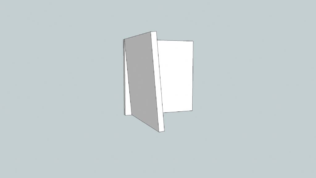

Ok, a some more information on the box im trying to construct.
The 2 pieces come together like below. The angled piece is the side, and the part at the end is the end cap. There would of course be another angled piece, and end cap, but this is just so you can visualise how they join up. There are 2 height boxes im planning, a 100mm high which has 2 joining holes. 150mm high, which has 5 joining holes. The parts are to be joined together with M3 screws.
I just need to get consistent holes drilled so that the parts are interchangeable.

24/11/2012 15:17:51
The 5 degree angle isn't on the drilling, I just mean the line of holes are on a line 5 degrees off the right angle. The picture from the top down view should show this.
Regards,

Hi all,
thanks for the responses.
im looking to use the jig to drill holes in over 100 plastic pieces. The pieces will create a tapered box. The holes on the top of the jig are set at a 5 degree angle. There are holes on the side of the jig that enable the ends to align to the angle.
I'm ideally after someone that can fabricate this for me. It needs a level of accuracy I can't achieve, as all the pieces made in the jig will be interchangeable with each other to make varying sizes of boxes.
If the jig has bushes inserted into it, can a softer material be used for the frame?
any more questions, please ask.
