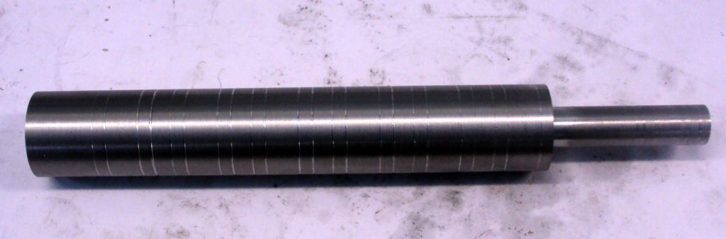

so the sequence goes something like this, make the blank then machine the flywheel dia. then maching the front bearing to 1mm oversize and mark out all the flywheel, bigend and center main bearings. next its off to the mill for indexing all the bigend location marks, mill out the bulk of material for the be to leave a small oversize square. this reduces the turning in the lathe for the b.e. journel. once all the b.e. and main journels have been roughed out i grind the b.ends to final size followed by the mains. Big end journels are turned with the crank mounted in a special fixture. finally cut all the chamferes on the flywheel faces and deburr and polish.

Well started the crank tonight, here are a couple of photos of the first two stages of machining
1st is bar stock cut to length and faced and centered both ends
2nd shot shows the front main fournel roughed out to go into a collet chuck.
3rd photo shows machining the flywheel diameter.
cheers for now
dean
