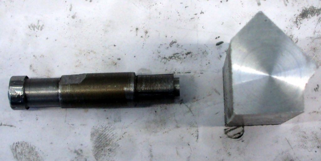

07/02/2014 21:38:30
Well I have finally finished all the exhaust stubs, what a mission! This step of the build was probably the most challenging for me in many ways as I wanted to have the typical aero v12 looking stubs, but how to do that without castings. So i machined a bar stock to the top view profile and then cut off the correct number of biscuit slabs. These were then set up in the mill after marking out all the relevant dimensions for drilling the internal holes. The first slab was set up to a jig formation and the others just inserted to repeat the process. This saved a great deal of set up time as i had to do it only once for each step. Once both holes were drilled I made a mandrel to mount the stubs on for turning both ends. When all the lathe work was completed I then finished them off with a file to final shape and cleaned up with emery tape. here are some photos of the parts etc
So next its onto machining up the split main bearings and backplate along with the prop driver and spinner nut. This will complete the bottom end of the engine.

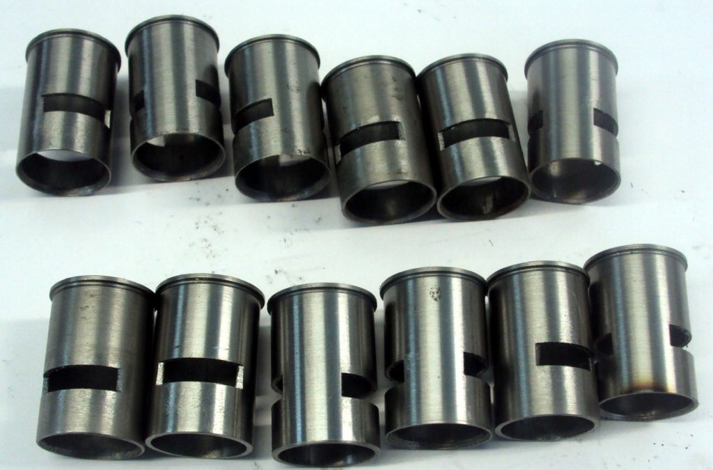

02/02/2014 00:17:24
So it has been a very busy time in the shed lately, have managed to make and finish all 12 cylinder liners, all thats left to do to them is  hone and polish with diamond lapping.v12 liners.jpg
I have also managed to machine the transfer ports into the cylinder fin blocks and machine the external profile shape to the heads and fin blocks
