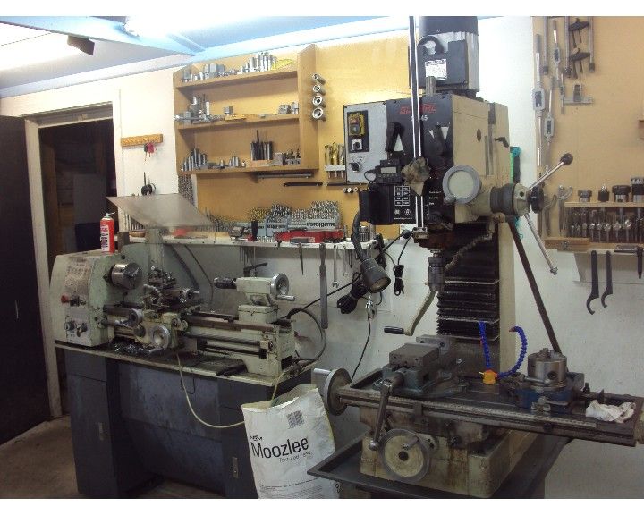

The other thing that s has been a major consumer of spare time over these last few weeks has been the total revamp of the workshop! basiclly i just got sick of spending more time looking for a tool than i spent using by about 600 percent........ usually the fastest way to find it was buy another, funny how that works aye!!!. well i haven't quite finished but I think we are mostly there, YAY now its back to making some swarf, should have achieved a bit more on the engine build this coming week. Here's a couple of photos of the workshop.

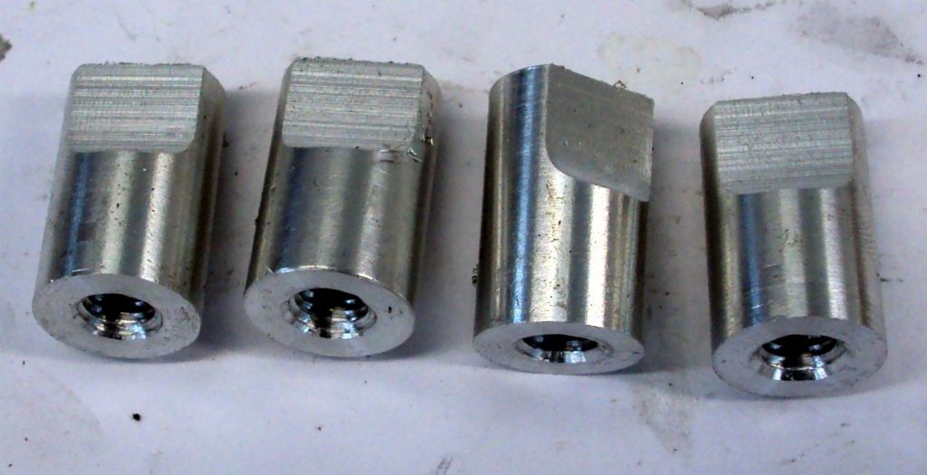

Well it's been insanely busy round here lately so not much time has been allowed in the shed but i have never the less been able to make a start on the conrods. photos below show the progress to date.
next step is to deburr them and radius the big end, drill and tap the bolt holes, seperate the big and cap and ream to final size. then its onto seperating the conrods from their partners and radiusing the little ends. then onto the pistons and carbs, fuel rail and ignition rails, plug inserts and then the breathing of life into the beast.
