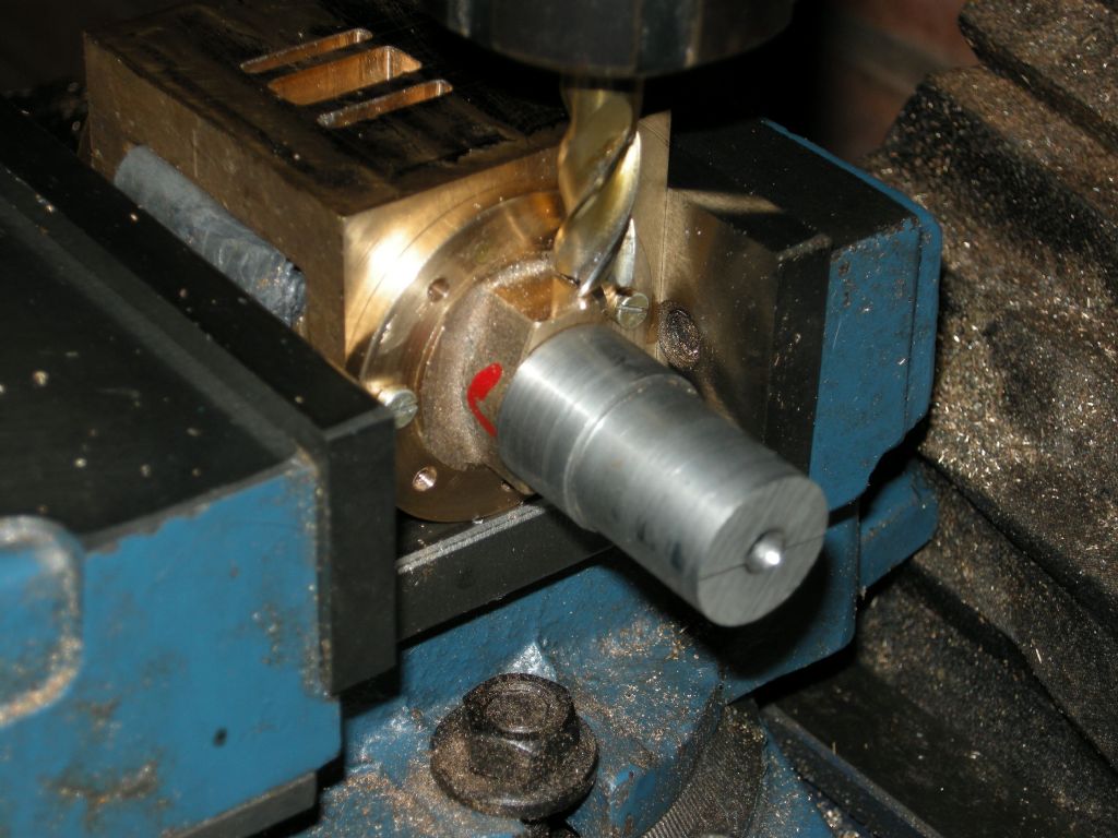

Machining the crosshead bosses
Since each surface has to be the same distance from the centre line of the piston I used a dummy whose major diameter is the distance apart that the crosshead slides should be. When the cutter just touches the OD it should be correct
