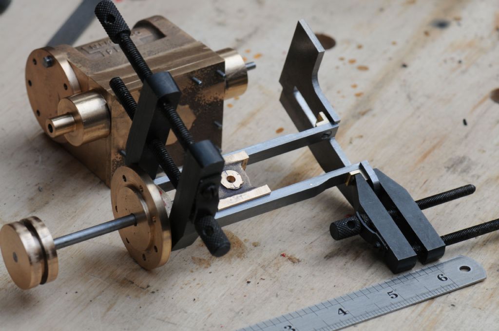

The spacing of the crosshead slides is fixed by the machinging of the rear cylinder boss and the rather delicate brackets on the angle plate. This is a photo of the first mock-up to check clearance
