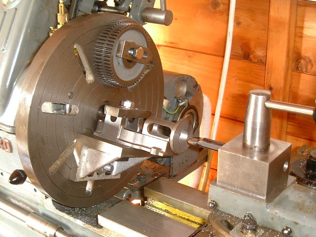

Machining the 10H trunk guide hole.
I mounted the soleplate on an angle plate on the faceplate. First I set the soleplate square to the angle plate then I set the trunk guide running true to the outer face of the cylinder mounting face. Finally I added some balancing weights to the faceplate.
