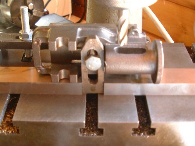

Machining the 10H trunk guide side slot.
I machined the trunk guide slot using two end mills. I started with a small end mill and then finished it to size. Note the parallel underneath to keep the soleplate level.
