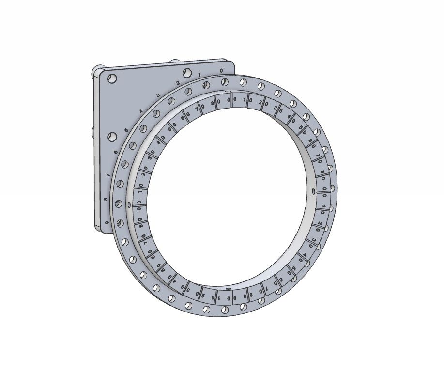

general assembly
The arrangement closely follows the design concept I used for my low-profile rotary table and simple indexer projects. The inner ring is a close fit on the spindle flange to which the chuck is attached. The vernier plate is bolted to the front face of the headstock casting on stand-off pillars. A 5mm dowel pin is used to select the desired positional rotation from the datum position.
