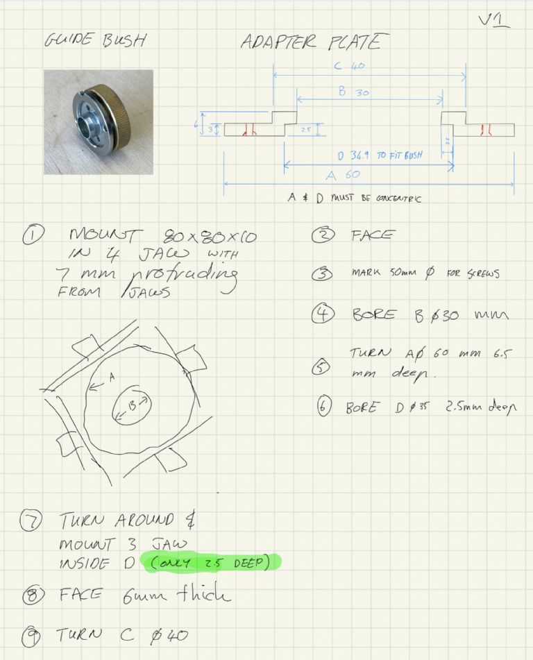

Machining sequence v1
Uploaded by Ivan Schuch on 30/07/2021 22:11:27
