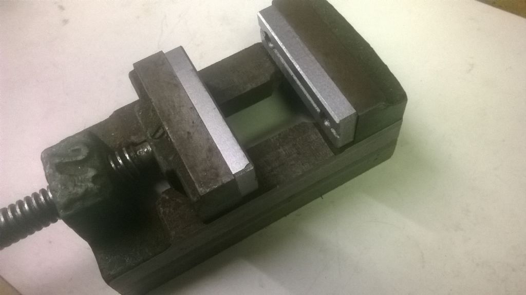

New jaws
I cut off the mounting "ears" and milled the resulting sides parallel. Made new, thicker jaws and ground them parallel, too. A central, 1mm deep groove serves to locate small diameter stock.
