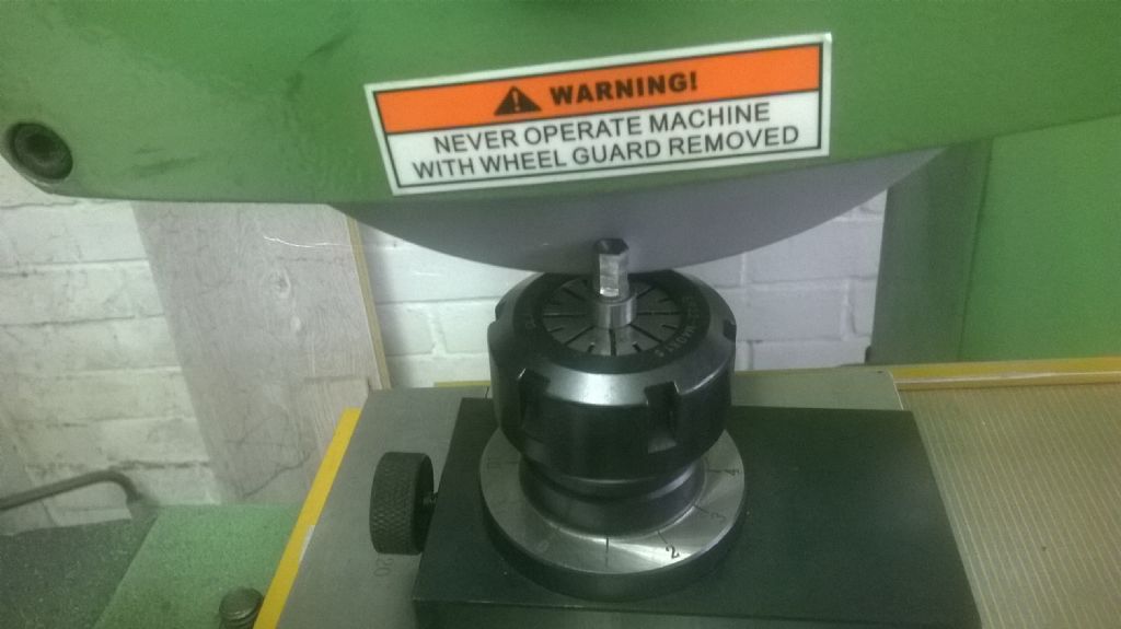

Grinding the cutter
Eventually settled on using the Stevenson's milling cutter grinding fixture to hold and index the cutter blank. This gave an angle of 2° relief to the edges as shown.
