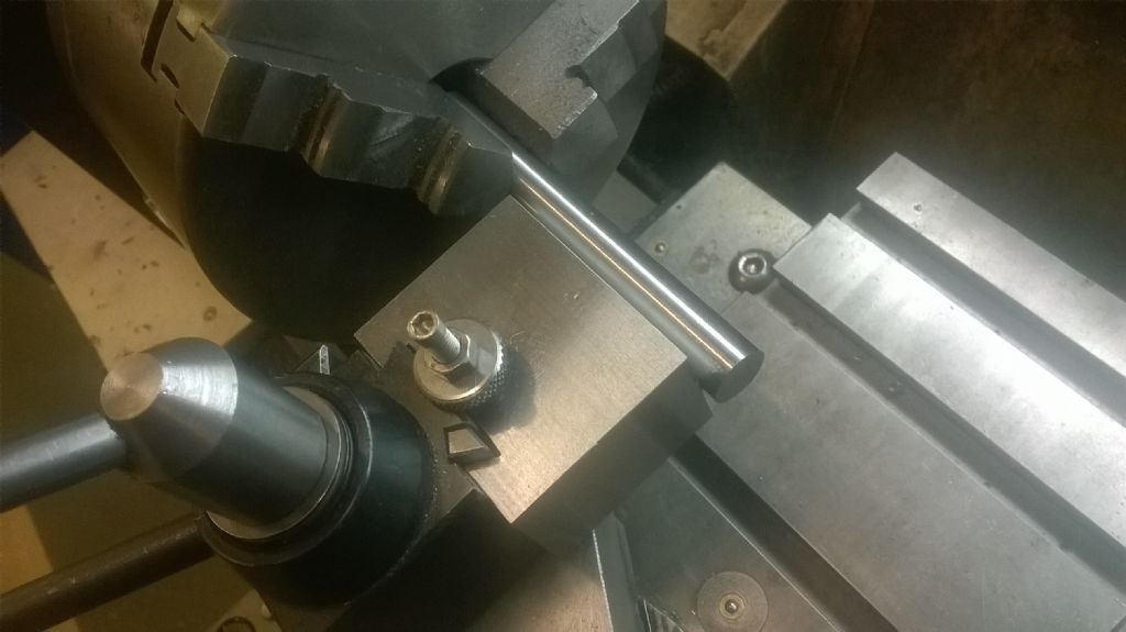

Aligning the block to lathe centreline
While the block is still square, it was mounted on the QCTP and its outer side aligned parallel to the lathe centreline using a piece of silver steel rod.
