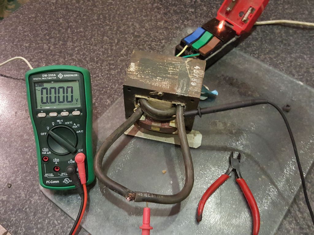

Current test 1000A!
Voltage drop of 0.13V over 16.5cm of 0.00078 Ohm/m cable gives >1000A currrent. Switched resistor in series with primary give low power mode.
