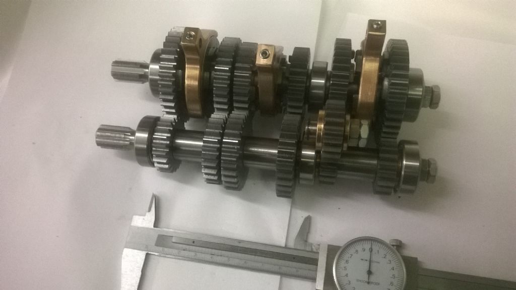

First trial assembly
Later ..... quite a bit later, the first trial assembly of the input-output shafts. Pleased to say they fit together well! The gearchange forks are just resting in the dogs, on the "wrong" side of the gear clusters, to give some appreciation of their relative positions. The caliper (open to 100mm) is there to give an indication of scale.
