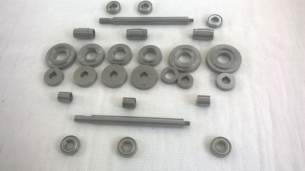

All the gear blanks set out on the table top, along with the input (lower) and output shafts, bearings and spacers. The oilite bushes for the output shaft gears are yet to be parted off to length and loctited into the gears. The gear hubs need their keyways cut and the input shaft splines need forming. But we're getting there!
