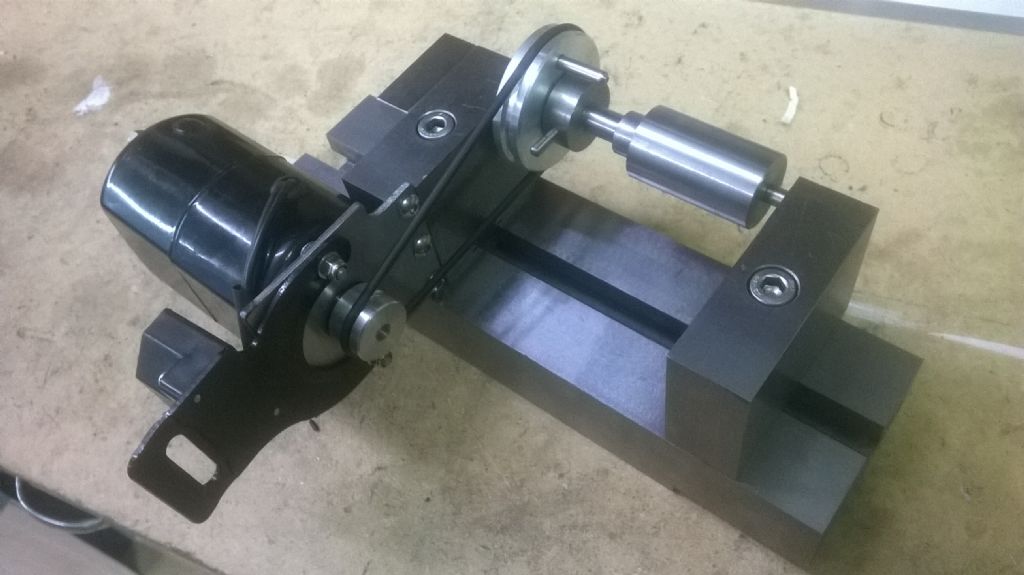

Replaced motor
When setting up the attachment for a video session, I found that the electric motor and/or power supply was under-powered and would stop rotating at the slightest provocation. Remembering that I had a spare sewing machine motor lurking somewhere in the workshop, I duly searched it out and compared its size to the existing motor. There wasn't a great difference in size so an hour later and with a new motor mounting plate made, the conversion was complete. Time will tell if it is siccessful!
