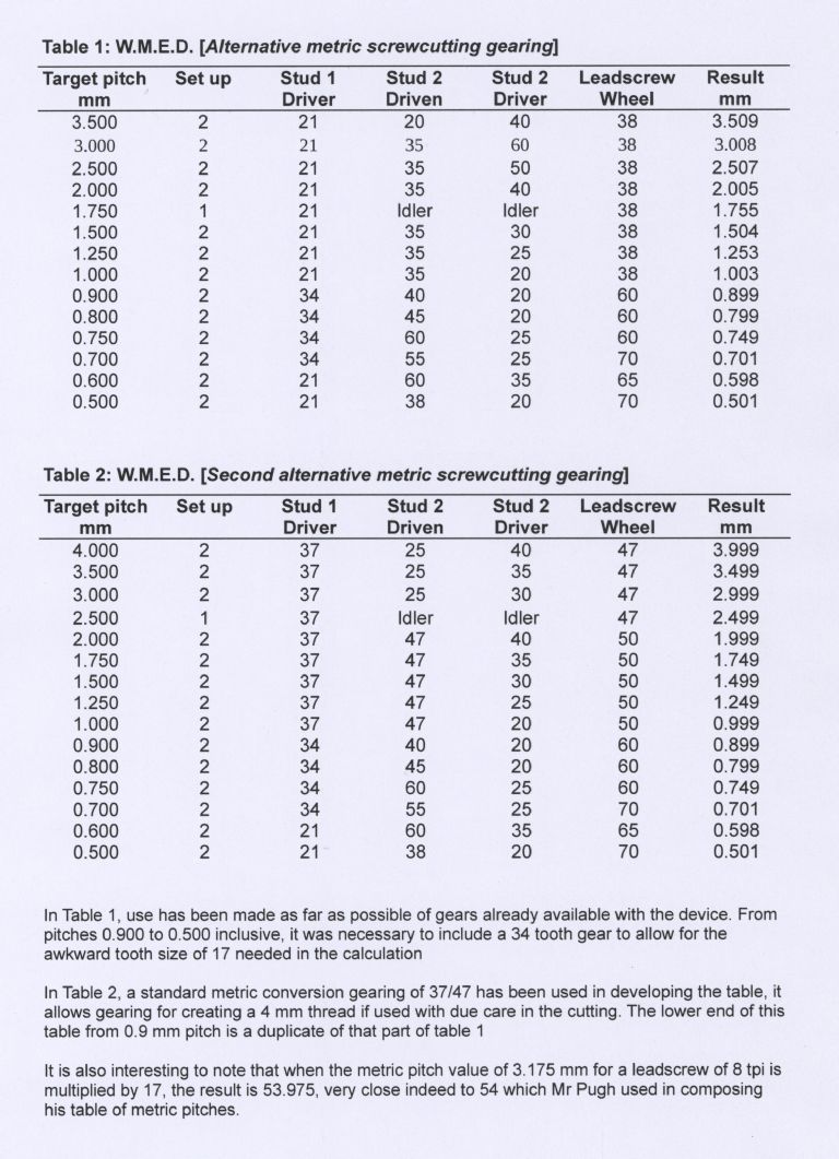

Two metric gearing tables avoiding the 17T gear
