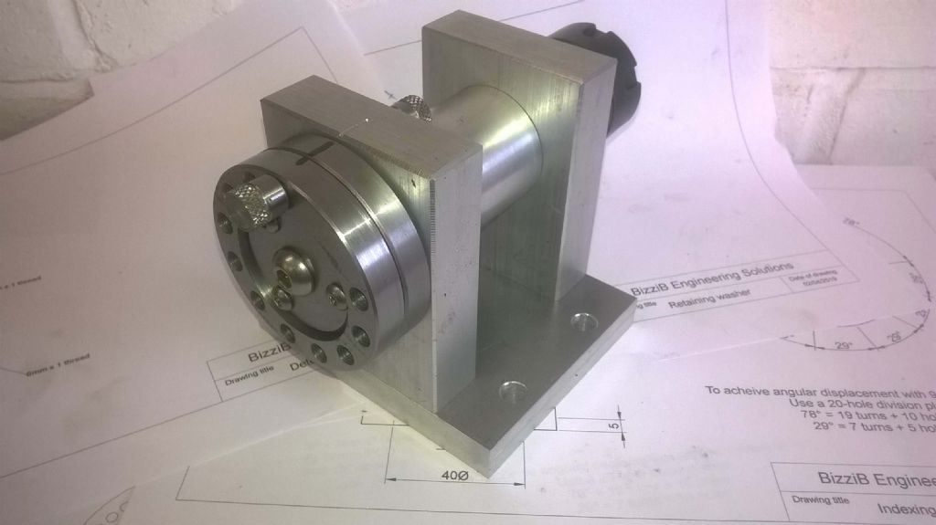

finished awaiting graduaton engraving
The finished attachment, awaiting the engraving of the sector lines on the periphery of the plates and stamping of the degree marks. The lines will be engraved on the mill, using the indexing of the fixture itself to give the required spacing. Number stamping is going to be more problematic and requires further thought to make a jig, I suspect.
