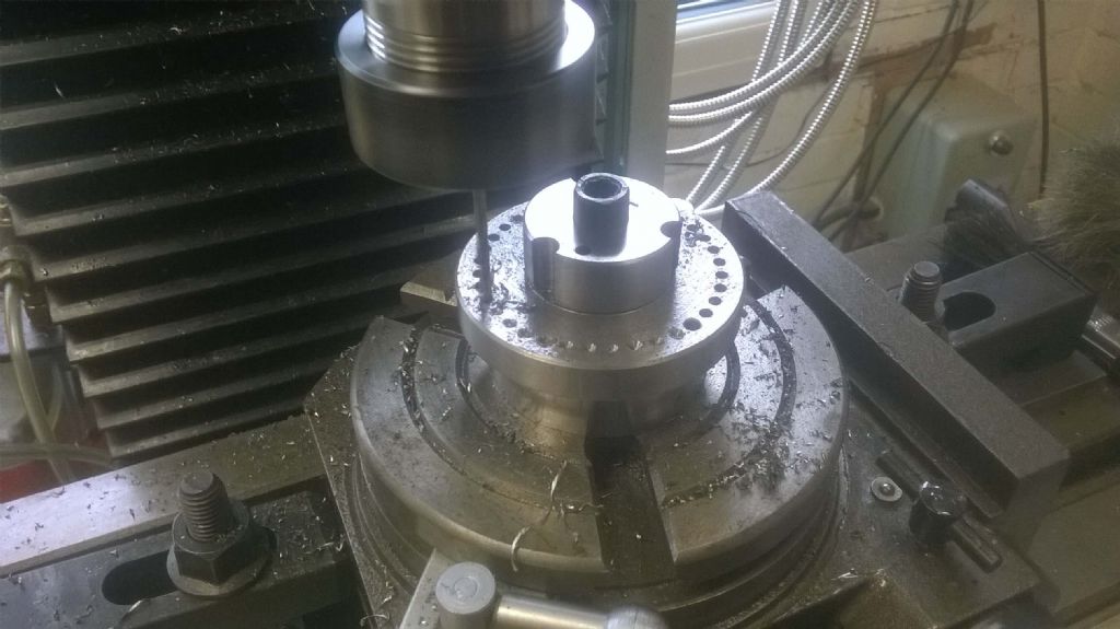

registration plate drilling
Drilling of the 36 holes on the reverse side of the registration plate on the mill with a rotary table. The holes were first all spot-drilled, then drilled 3mm diameter nearly to depth, followed by milling to full depth with a 3mm milling cutter to obtain a flat-bottomed hole. VERY tedious!
