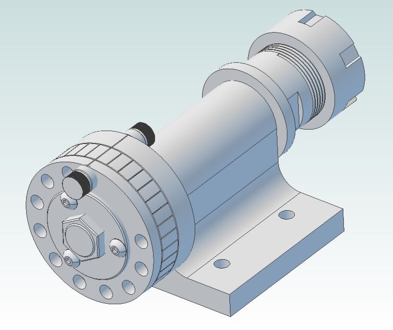

Another "final" design
Tidied up the body for ease of production from stock instead of casting. Altered the locking washer and added an oilite bush to the reference plate. Also relieved the reference plate by 0.25mm each side to give a running clearance. Just got to make it now!
