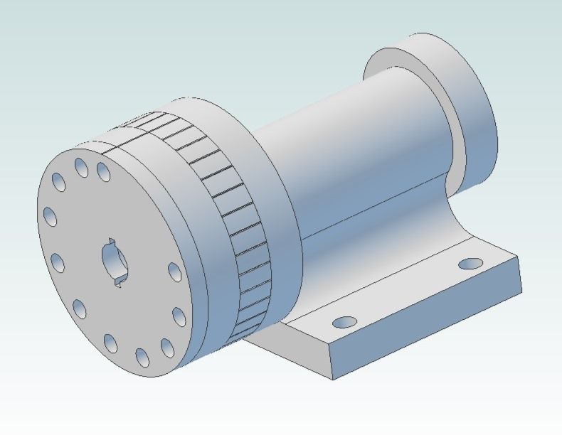

First iteration of the complete indexer body - minus spindle and bearings. I intend using a 100mm shaft ER25 collet chuck (because I've got one) and 6800RS bearings in the body. Pins inserted in the various holes provide location detents for the degree rotation.
