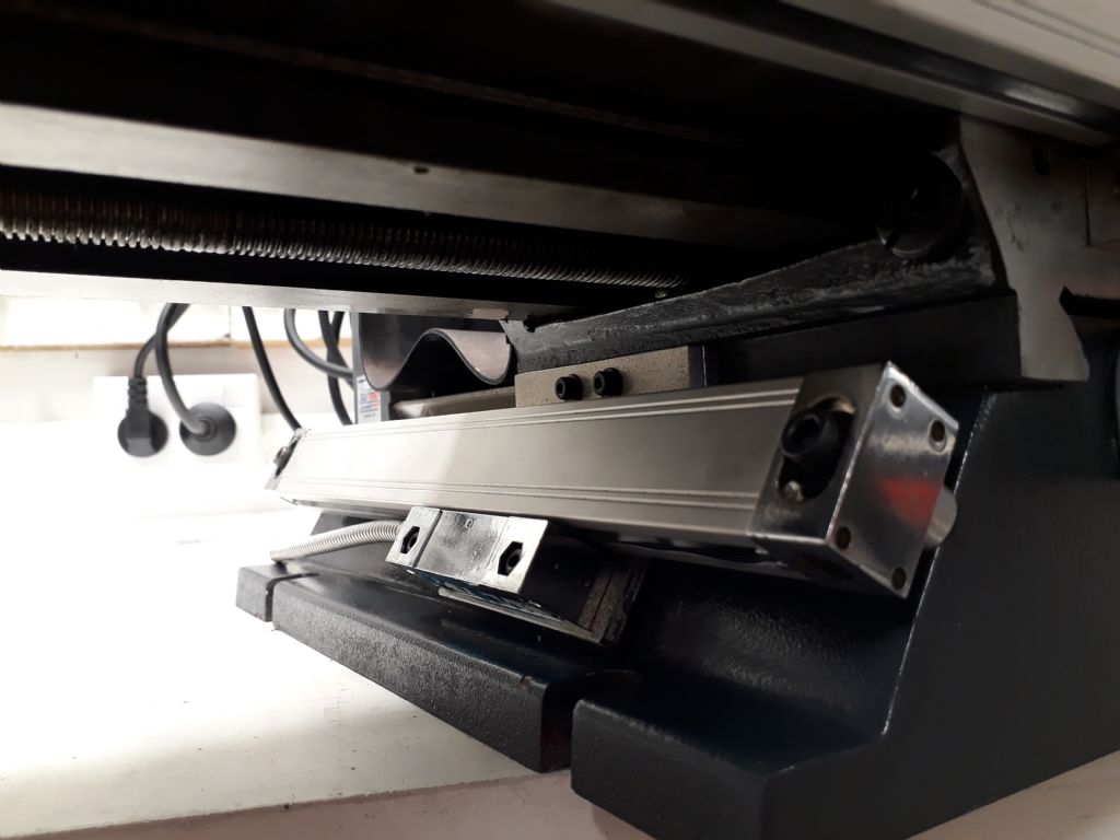

Y axis was hardest. Bent 5mm ally plate to 31 degree angle and bolted to Y chassis using existing tapped holes. Spaced scale out from base about 7mm
