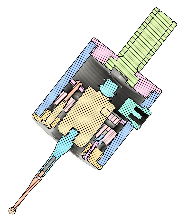

Section of V2 with ball ended spring
Ball ended button added to end of spring and hub given 7mm radius for it to sit in to improve repeatability. Silicone pads replaced with nylon screws.
