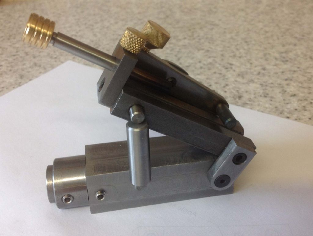

4-facet drill grinding jig
The pin in position to set the angle. Once the angle has been set, the clamp nut (on the other side) can be tightened and the measuring pin removed. I found this a simpler method than described in the instructions, which merely required one to set the angle with a protractor or angle blocks, each time the jig was used.
