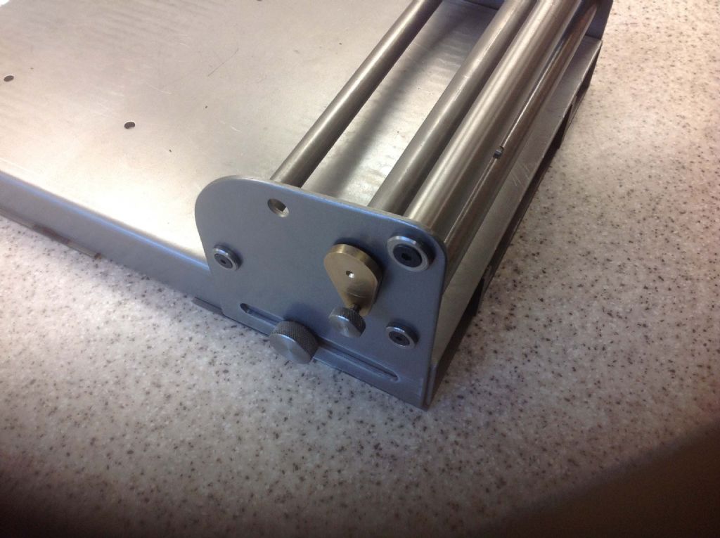

Engagement lever
I have replaced the plastic sleeve with 2mm thick-walled steel tubing to which the engagement lever is fixed. In use, the lever will swing the traversing engagement pin into and out of alignment with the sliding block and lock into detents in the side plate with the screw fixing at the smaller end. The detent postions have yet to be determined.
