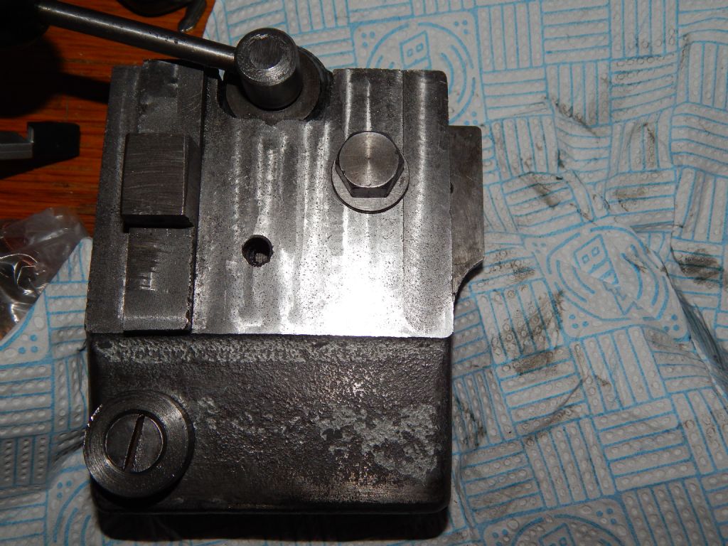

Cut top again is still a little high but under 1mm
mounted bolts and temporarily super glued on the ring i made to fit top. This was so that i could drill it from behind to insert a rod that I will silver solder to it . This will make one piece that I can re-drill which will anchor itself into the casting.
