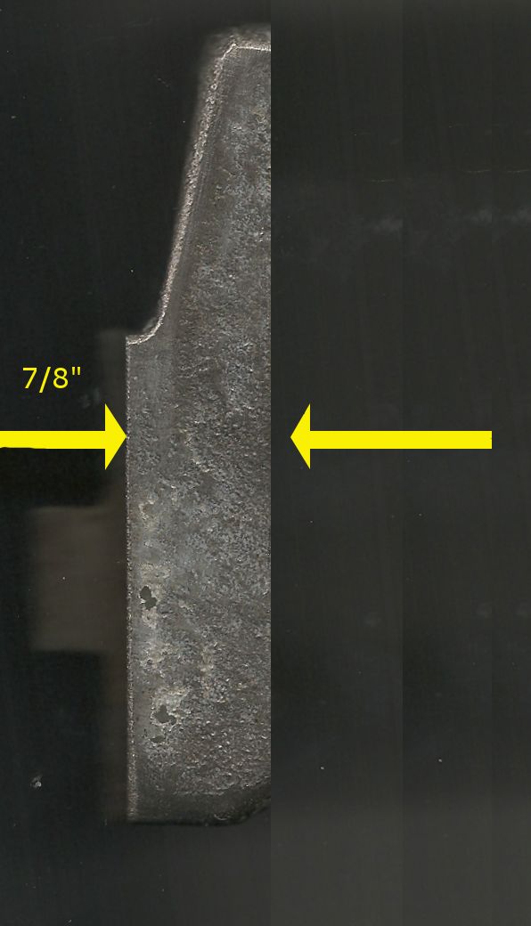

cut off for saddle first try in picture editor
Here is the first look at it. This is the pictures scanned in of the original saddle shown cut down to 7/8” this would need a 1 3/8 channel through the bottom to fit on to the existing slot on the Drummond tail stock mount. New bolts and threads in this would be required but the two slides would work well. I measured the distance as accurately as I can.
